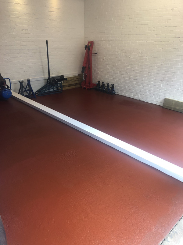

Off to collect my car at the weekend and looking forward to getting some miles on the new engine over the next few months.
I have decided to treat it to a new dust cover (for internal use in the workshop only).
Research has shown me there are a plethora of choices and costs so thought I would see if anyone on here has any specific recommendations that they are particularly pleased with.
I hate being without the car - nothing to do - even the workshop has had a makeover.

A neat and tidy workshop/garage is the sign of a person with a sick mind

Unless you can guarantee a humidity level of 55% max, do not under any circumstances put a cover on your car for reasons already mentioned. Secondly, and looking at the cleanliness of your garage, I imagine you are very fussy about the condition of your paintwork. In which case to cover a car risks further fine scratches on the paintwork, as the cover is dragged over the paint finish when putting on and off. I proved this following mopping my paintwork with a rotary polisher, and no matter how carefully I put the cover on, I got some fine scratch lines. When you have a concours paint finish, a cover is certainly a mistake. As for Chrisfell with the candle wick bedspreads, well, need I say anymore! Having said that, not everyone is interested in a concours paint finish, each to his own.

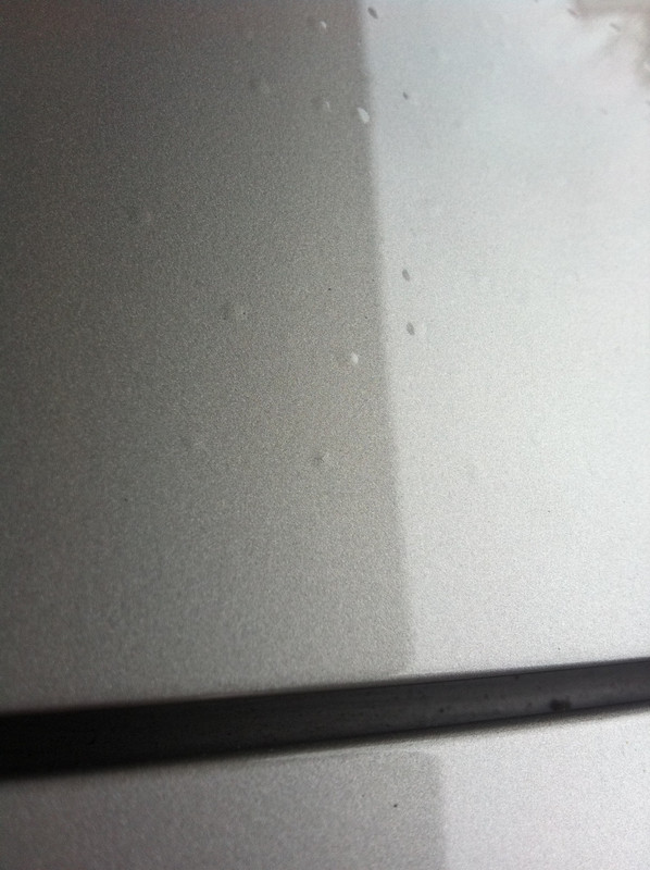

I thought it would not happen to me but, Micro blistering DOES happen....
This was on a car that had a custom made fleece lined car cover fitted. The result was having to strip the paint off back to bare metal.

Hi Clive......yes microblistering does happen...but how can you be sure it was the car cover and not the paint application contitions....Steve
