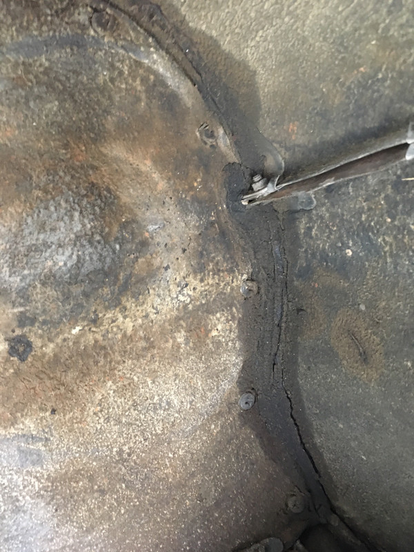

I am in the process of installing a Monocoque covered headlight system in my 69. Chuck provides a nice replacement kit which includes new diaphragms. I have discovered that the original (and the replacement) diaphragms don't fit snuggly against the bonnet and fenders even with the little flanges that are attached to it. I obviously have to fill in some seams and even holes. 3M 4200 sealant was suggested but this seems to be difficult and expensive to find. I was wondering if anyone has found a nice sealer that holds well but that remains flexible. Auto parts stores sell a variety of black silicone based sealers and that seems like an obvious choice but I might be missing something. Any thoughts?
I have attached a picture that shows the old "goop" that was used to plug the gaps around the diaphragm.
