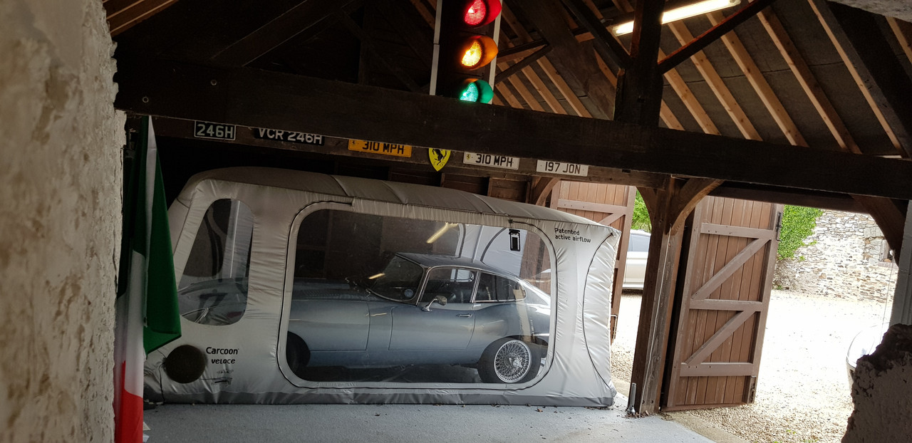

I prefer my carcoon veloce. Easy to get in and out due to the frame. I can look at it through window! and get into it quickly without taking off the whole cover. Also no scratches pulling the cover on and off. Keeps it dry and moisture free. You can put it away if it gets a bit dirty unlike normal covers. Finally it also keeps away rodents.

Excellent, Jonny, particularly in the type of garage you have. Lofty open roof space with what looks like an old clunch wall at the back, gives an opportunity for condensation to form. The Carcoon solution with the fans, keeps humidity levels low and also keeps away rodents as you say. I used a similar solution before I could design my own garage to counter condensation, well insulated (u value same as a house) and an open roof with no trusses using what is called a flitch beam (so capable of one car above another.) I live in the country, so rodent control is important, so I have flexible rubber seals on all doors. I still have professional de-humidifiers on automatic control on the odd occasion when humidity rises above 55%, with external drainage to the outside. To get back on theme, therefore, no need for a cover!

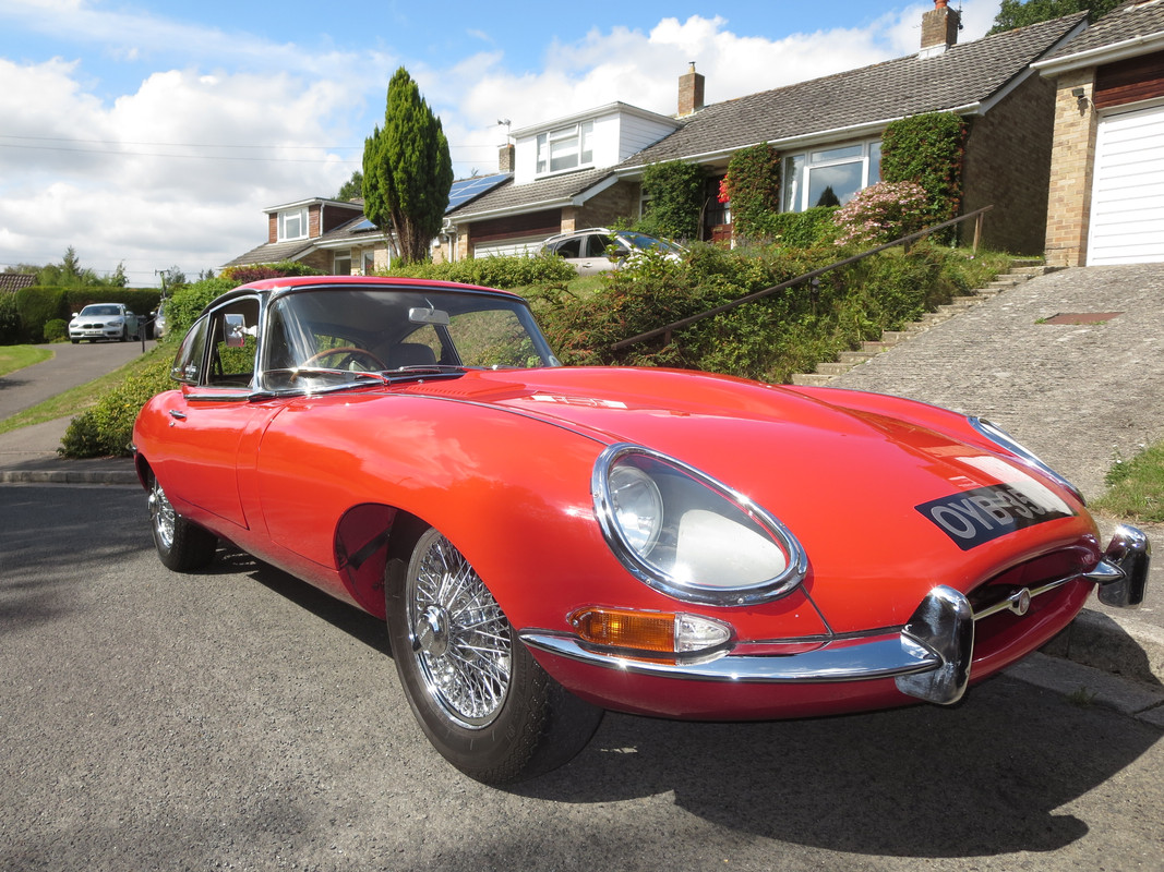

I’ll advocate the opposite viewpoint...ever since I had my ‘64 OTS fully restored 12 years ago I have always used a car cover. There has been absolutely no degradation in the paintwork during the years...in fact, I am convinced that the use of the cover has protected the car from dust and grime and has therefore dramatically lessened the number of times I need to wash it. My car cover is a Cover Craft Form Fit, made of polyester and spandex and it fits the car perfectly:

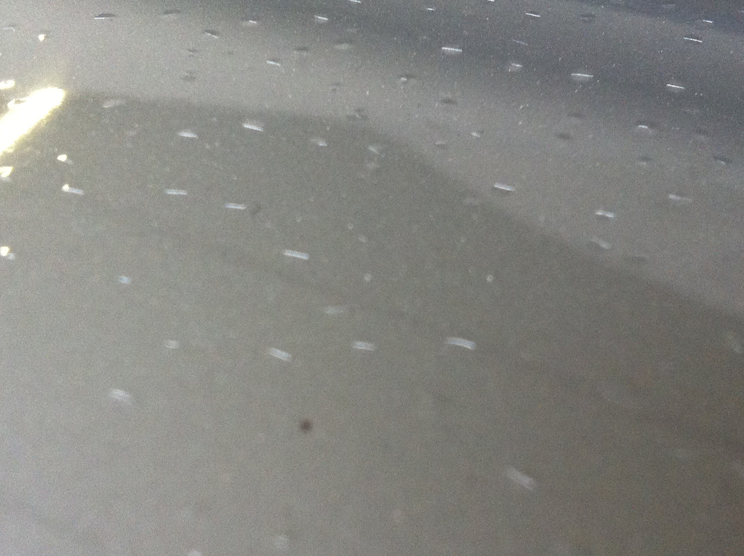

I thought it would not happen to me but, Micro blistering DOES happen....
This was on a car that had a custom made fleece lined car cover fitted. The result was having to strip the paint off back to bare metal.

Hi Clive......yes microblistering does happen...but how can you be sure it was the car cover and not the paint application contitions....Steve
