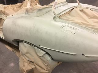

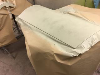

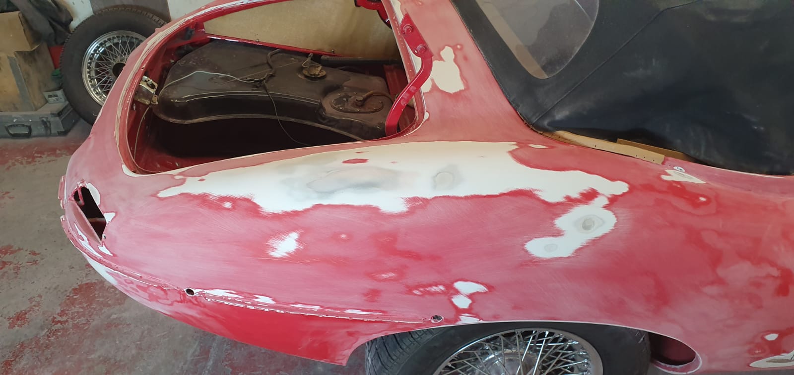

[dropshadow=] pop[/dropshadow]Refresh well underway. The body work generally is very good except for the bottom of the front wing arches were water has managed to get into the rolled bottom edges were they land on the extended cill. New part / repair panels from Hudsons are being welded in on both sides. A few pictures to she progress.
Tony (E typed)

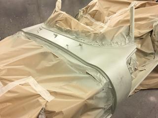

A little further down the road with the re spray

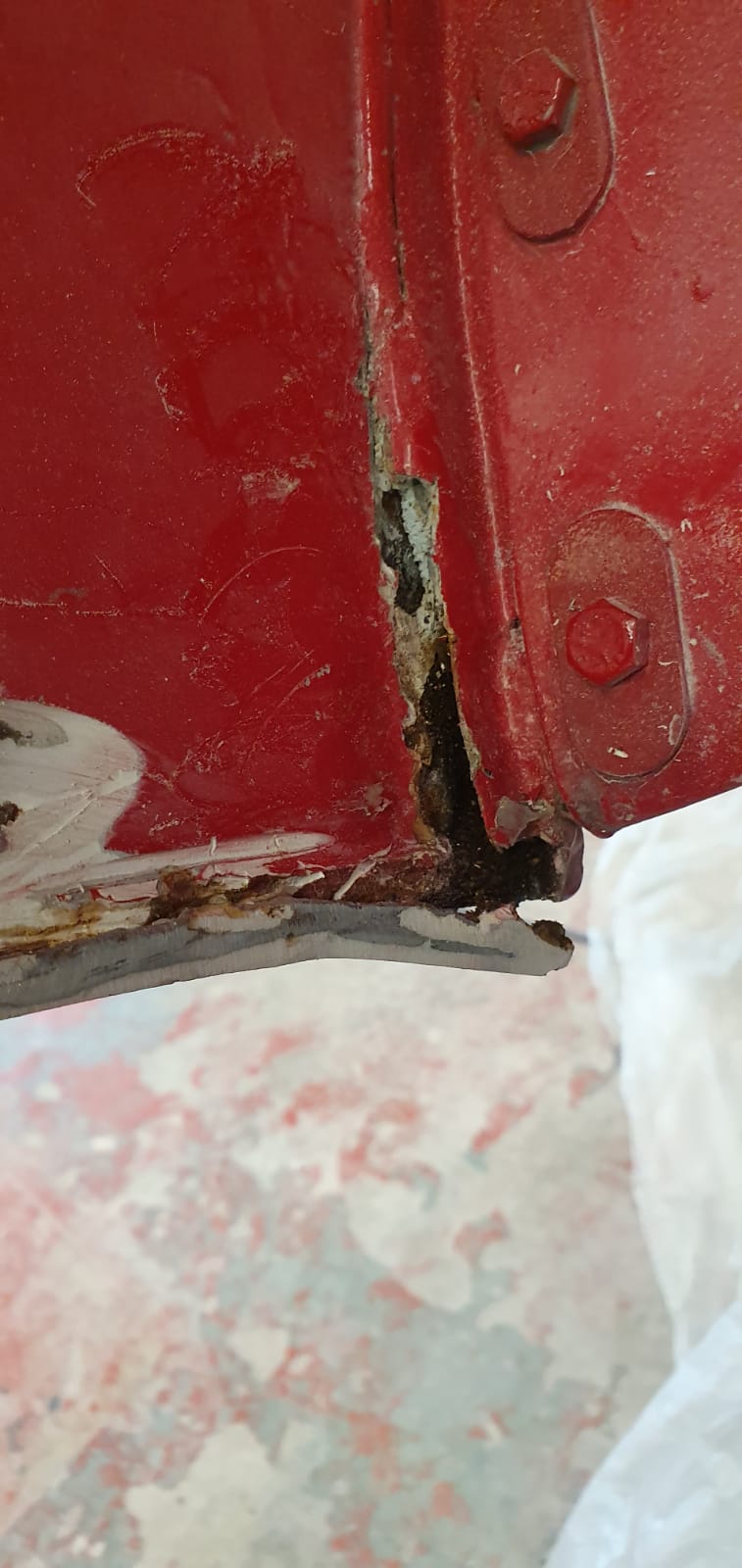

If you look at the area marked in blue pencil, I believe there should be a hole to take a rubber block attached to the A post door seal, Is this correct as mine has either been filled in or does not exist. Can anyone enlighten me.

Anyone know the answers to my questions regarding the stick on front number plate colour. Ie, White on black or silver on black and if there should be a hole to take the door post rubber as circled in the picture above in blue.

As far as your door jamb is concerned, I've just been to look at my cars, and the whole area is covered by the door seal which is glued to the screen pillar and then forwards and then round the entire curvature of the bulkhead. It is quite thick at the base of the pillar, to provide a buffer. You are welcome to look at mine - I shall be around most of this week

My shut panels did have triangular ‘indentations’ to allow the ‘blocks’ in the seals to locate. However, I still had to trim the blocks to get a good fit.
