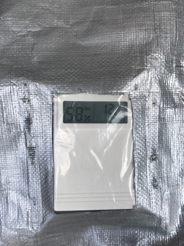

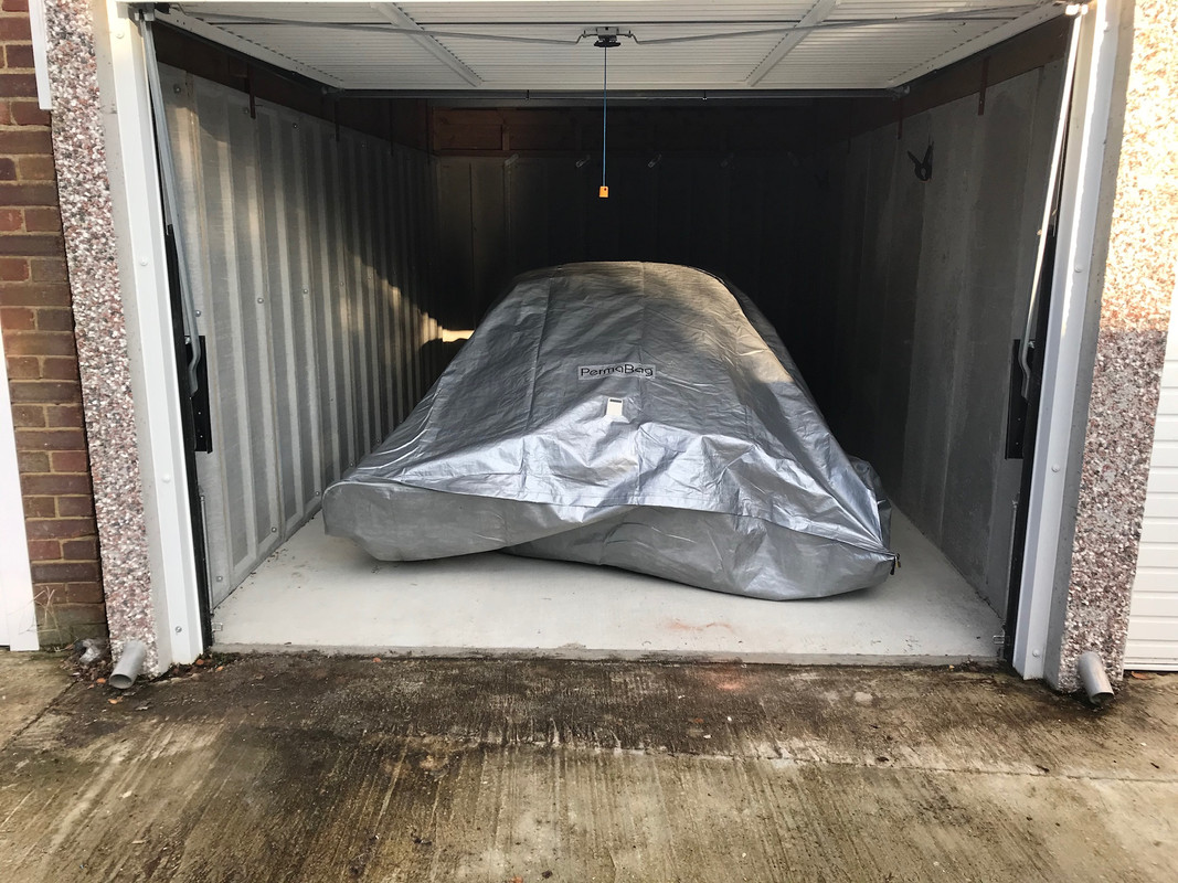

I’ve got my E put away for the winter stored in an air-tight bag. Battery completely removed, tyres sitting on tyre-savers, fuel stabiliser added to tank, two large dehumidifier packs and a generous amount of wax over the bodywork.
The bag comes with a humidity and temperature display so I can check the humidity is around 50%
Looking forward to next March
