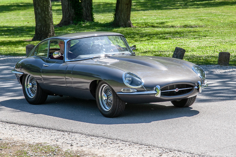

Hi all looking for some advice / ideas
Do the door frame mounted mirrors work , in regards manovering the car around and not just for driving and overtaking ( or looking out for rossers behind :bigrin: )
Also if they do I'm looking for some round ones I saw on an E some time back similar to the ones in photo ( which don't fit an E Type door frame ) .
Cheers for any ideas or even photos
