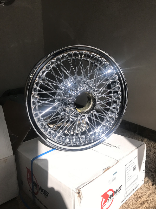

Just taken delivery of 5 MWS 5x15 chromies.
These are to replace the black painted versions that were on the car when I purchased it 4 years ago. This will be the last ‘to-do’ item before I declare the restoration ‘complete’.
Got a great special offer deal from SC Parts, which included a free gift choice worth £250!
I now have 2 choices in terms of tyres.
1. Re-use the 205/70 Vred sprint classics that are on the current wires which only have 200 miles on them and seem perfectly good for road use, (but low speed turning is a bit too grippy) or
2. Get new set of Vreds with 185/70 profile and sell the old wheels with tyres as a package?
I know most suppliers favour Cinturato or XVS but these seem expensive when compared to Vreds and for normal road use I would need convincing that there is any noticeable benefit when they are twice the price?
Any views?

You need at least a 5.5” rim for 205 width tyres, so re-using your original tyres isn’t an option with your new wheels.
In terms of Vreds vs other tyres, there seem to be as many opinions on tyres as there are members on here. If you’re happy with them, buy them again. If there’s a particular trait you don’t like, then that might be something that could be addressed with different tyres.
Bear in mind most opinions on here are slightly skewed. Most people only buy new tyres when the old ones are either worn out, or so old they’re due replacement. They’re comparing old and worn out with new, so whatever they fit immediately feels better. Unless you’ve got feedback from someone who’s done back to back testing of several brands of new tyres (across all conditions), you’re unlikely to get meaningful information.

Fit 185VR15's - you will love the way the car becomes alive!
Bear in mind the Vred's are not VR rated so the Pirelli's are certainly worth considering. The VR rating does not just apply to maximum speed but also load weight and cornering performance.

My originals are 5x15 Tom (according to Turrino Wheels). I had read conflicting info froM tyre suppliers that 5.5 was the minimum for these tyres as well as 5.0 being the minimum!
I think I’ll go down the new Vred route and get Turrino to refurbish the old wires back to silver painted spec and sell with the 205/70’s
