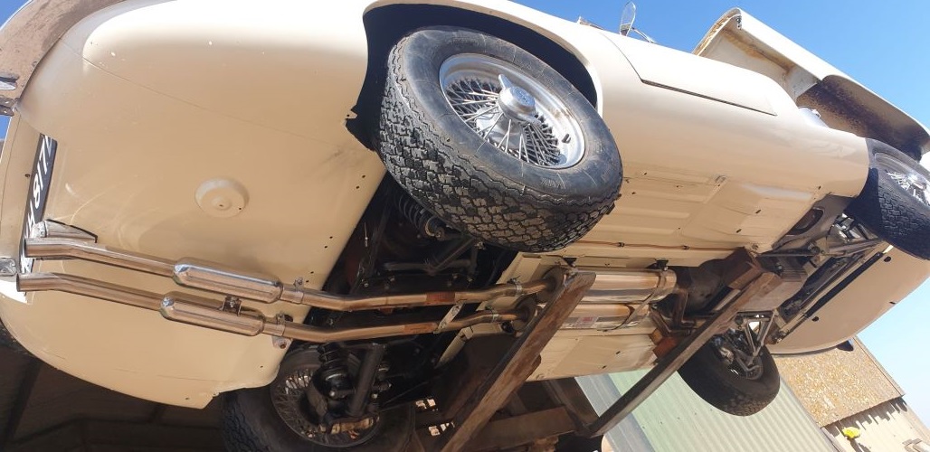

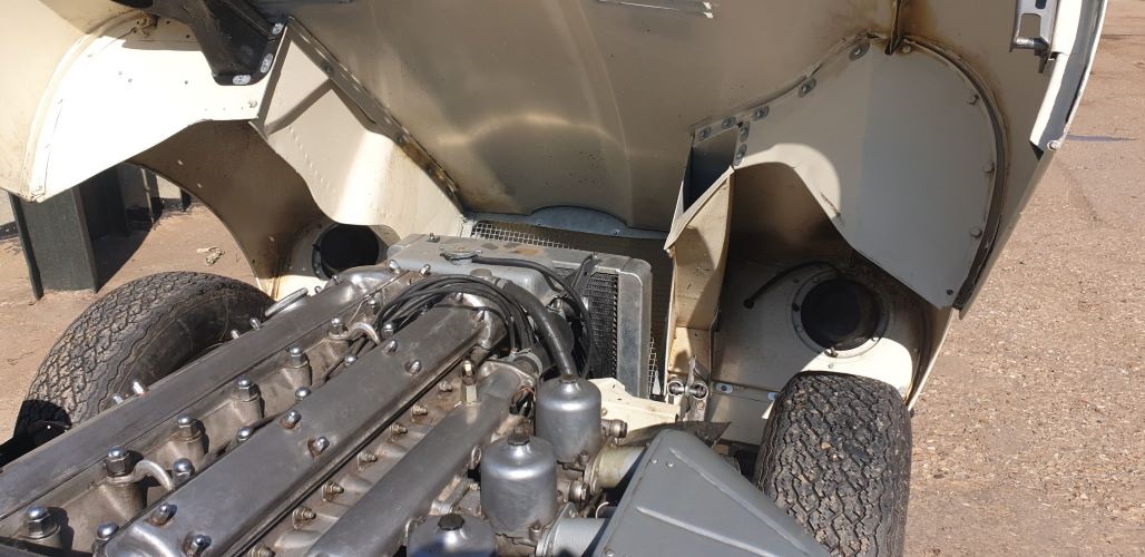

I dont go in for cleaning cars much, but cleaned the underside of OEW this afternoon.
The virus has obviously sent me mad.
How does the heat shield attach in-front of the center boxes?
Bracket off the gearbox?
A huge mystery.
Any picture please.

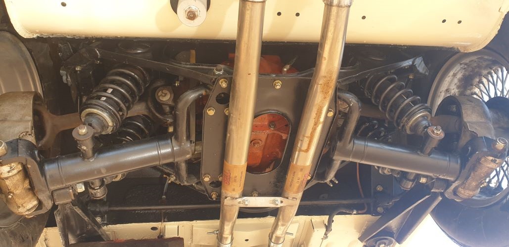

A few more pics. I am finding posting pics painful again.

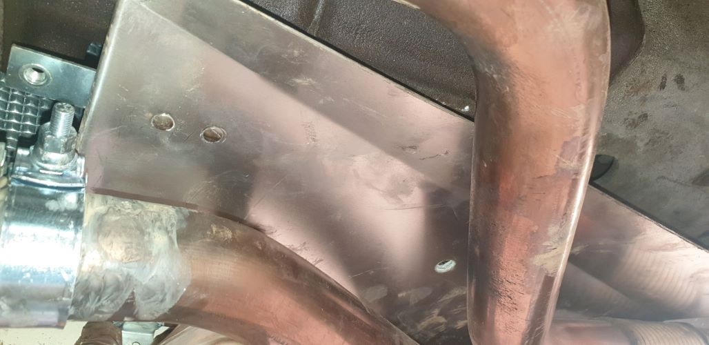

The offending Heat shield below

Ref the heat shield, two fixings to the chassis rail and one to the gearbox mount as the pic....

I am now clear on the two brackets that attach to thee chassis legs. Its the rear bracket that gets me.
The shield is supplied with a captive 5/16 UNF thread at the rear in the location of the silencers, What is it that screws into it?
I cant seem to find reference to it anywhere.
Any ideas? Simon, I think it is obscured in your picture.

It screws - or in my case was pop riveted - into a short metal strap (3 inches long?) that runs back to attach to the gearbox cross support/mounting.

And - when I fitted the gearbox heat shield I puzzled over why it wouldn't fit for a long time and then discovered that the bracket arrowed by 288gto was assembled upside down.

Ahh, I think mine might be assembled back to front. Thanks very much.
