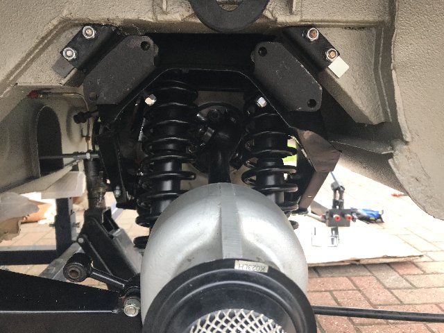

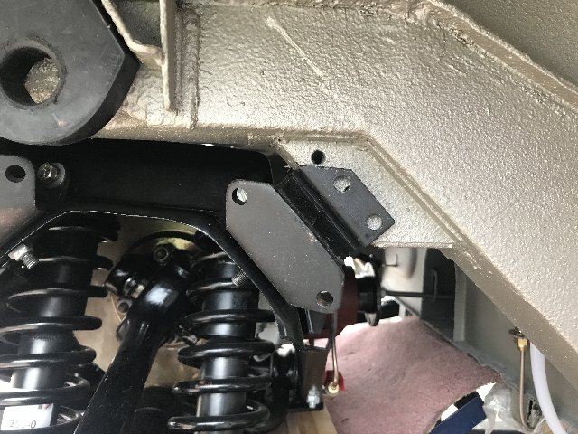

As I rebuild my IRS I ran into very bad Part quality from a main supplier starting with an S ans ending on G.
The worst were the so called ‘best quality’ rear suspension mounts. Not the Poly ones but high end rubber mounts.
As they are 1 cm higher then the genuine ones, and installing creates a bit of a funnel for the irs cage, it turned out that 1 cm on both front and back added up. The weight of the car could not compress the rubber so that the mounting holes lined up. The irs just could not be reinstalled. After trying, dropping, trying, dropping the IRS 3 times and 6 hours later I gave up. Grabbing the old rubber mounting went straight forward and 30 mins later it was done...
Just wanted to say this....

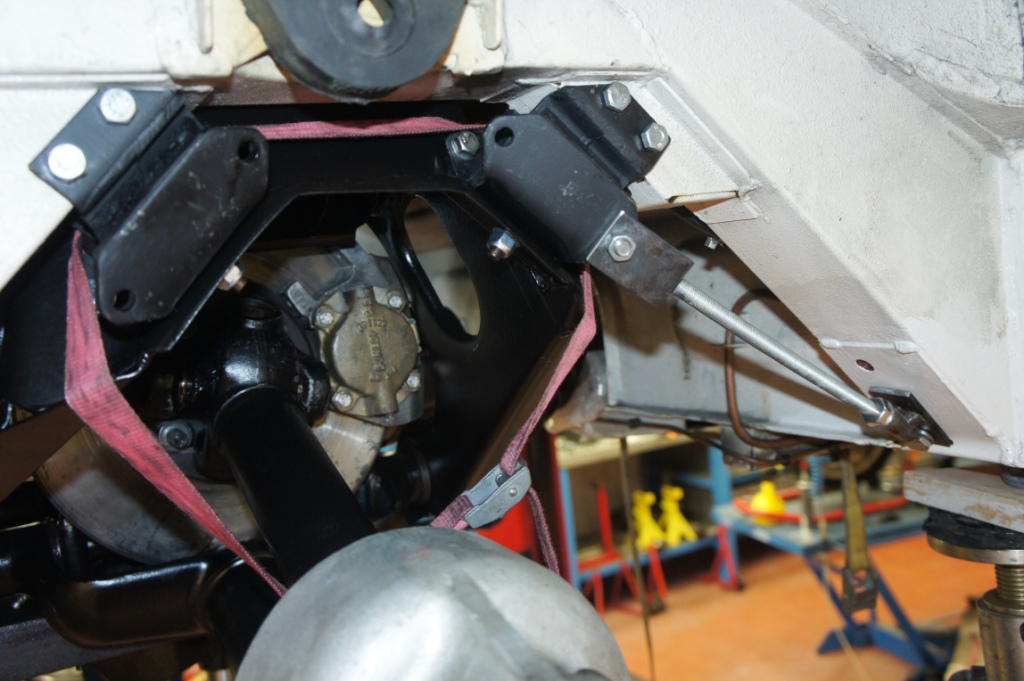

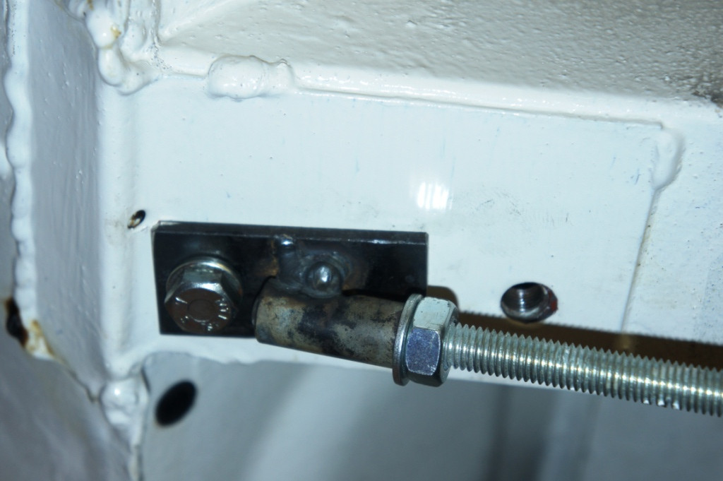

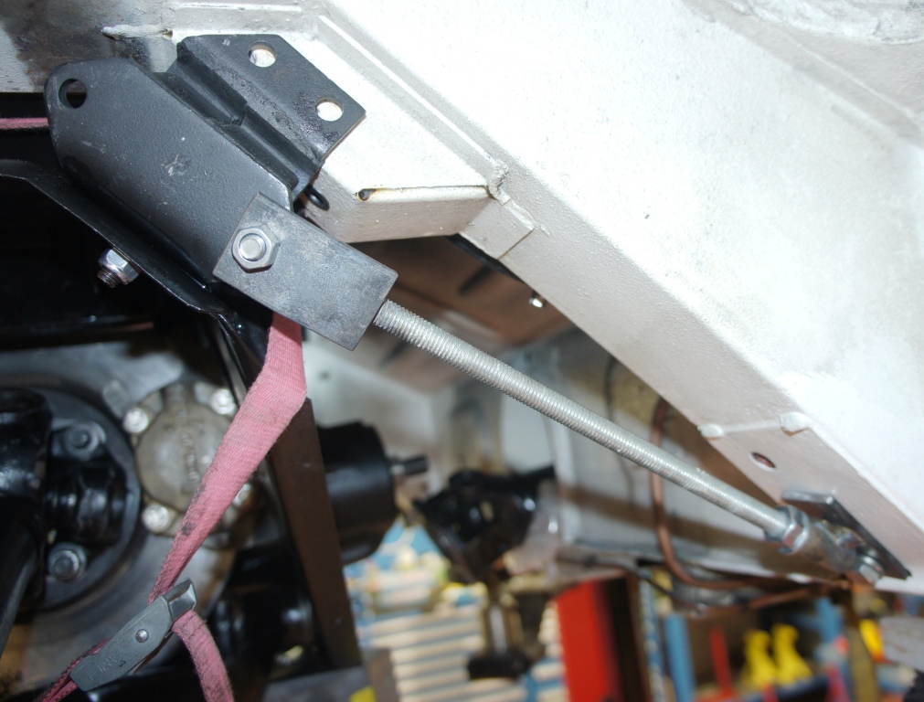

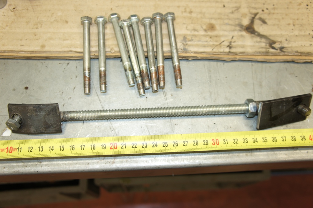

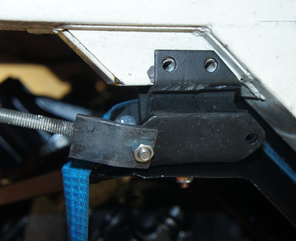

Fitting the IRS with new rubbers (mine came from SNGB too) is NOT an easy task, personally I am convinced the factory would have had fitting aids with levers to speed this up, and if you search the Forum there are some pictures of a very simple screw-jack I made that made lining up the holes a doddle.
viewtopic.php?f=3&t=5843&p=41323#p41323
The rubber-fitting issues and suggestions are covered in Post #6.
The reason that fitting these can never be straightforward is that IF everything lined up straight away, once they were loaded up there would be a considerable permanent shear force front-to-back across the rubbers, whereas the intention would have been that it was just compression.
We have all had rubbish from SNGB, but as far as I am aware nobody who has ever raised an issue has ever not been listened to, or refused a refund.
You might ask Julian why he doesn’t copy Rory’s screw-jack fitting tool, after all the prototype has been sitting on his desk for about a year now.

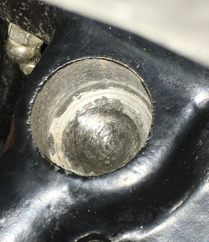

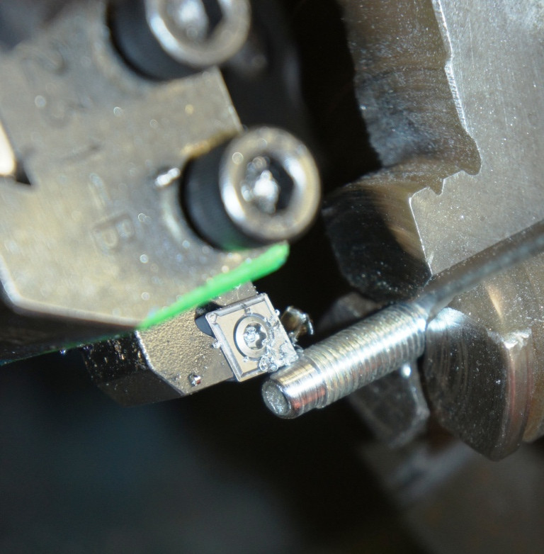

As has been said, new rubbers are horrible to fit. My first effort left me with a stinking headache so bad I had to walk away and do what I have never done before and leave a load supported on a jack only. That was on the supposedly easier 2+2 shell.
I returned later to make things safe and next day thought it over. I made bullets from bolts filed to a point and heads removed. I used awls, pry bars and anything I could get my hands on, probably the most useful technique was to get the easier bolt of each mount in place with the nylon nut safe but not tight, then remove the jack and re-jack at the nose, then rear of the unit, wiggling the mount until bolts finally went in. I also started with a very stable jack and IRS set up, the IRS was firmly bolted to the jack and could not fall off. I used a home built adapter which was a great help. Design may vary according to the jack design you have.
Not sure if my mounts were SNG, but they probably were. When I removed and reinstalled the unit a couple of years later, it seemed much easier, experience, or the rubber mounts had squashed up to make it easier? Probably both.
Good luck with your next attempt!

It is definitely one of those E Type jobs that is hard work the first time. Then you become an expert (and don't need to do it for ten years!)
- I had the luxury of borrowing Rory's alignment tool which was so helpful. It then went to SNGB from me.
- Some good long pry bars help too - forget 12 inches - big long ones.
- It is better with two people
- As the unit is starting to get close use the old bolts to align holes (tapping through with a hammer) then replace with new ones so you do not spoil threads.
- Front V blocks on the IRS, rear ones on the car before you offer up the unit.
- The Radius Arms only line up when you put the wheels on and lower the car back to the ground.
All SNGB parts were used for mine - they were fine. Your original post talks about being 1cm out. There will be times during the process you will be very happy only being 1cm away!!
Good luck and tell us how you get on.

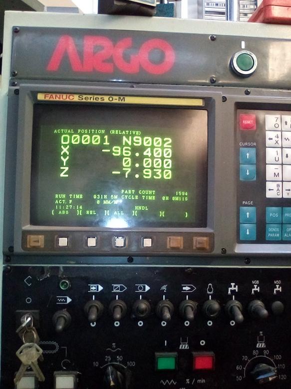

Post by angelw » Tue May 05, 2020 9:46 am
Hello Rory,

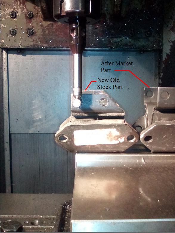

I've never had a problem fitting the IRS of an E Type and I've never had to resort to anything move brutal than a suitable sized Plus Driver to align the minuscule misalignment I've observed with the mounting holes. The caveat though, is that I've been fortunate in having only original manufacture parts to work with. Back in the mid 80s, I purchased a lot of stock from a BLMC dealership that was changing hands and changing brands.

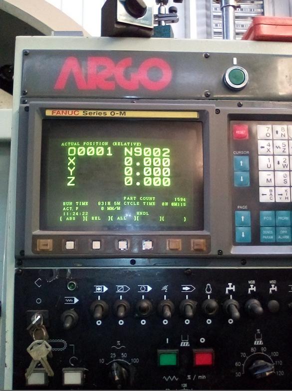

The following pictures are the comparison of an original NOS bracket (on the left) with a current, After Market part.
The following picture is the height probing of a neat fitting pin in a hole of the After Market Bracket.
The following Picture is of the Position Display with the Z axis Zeroed as a reference when comparing the height of the respective hole in the NOS Bracket.
The following picture is the height probing of a neat fitting pin in a hole of the New Old Stock Bracket.
The following Picture is of the Position Display with the Z axis displaying the position of the hole in the NOS Bracket, relative to the respective hole in the After Market Part.
You will note that the hole in the NOS unit is 7.93mm lower, relative to the corresponding hole in the After Market part; closer to the 1cm reported by the OP than not. Neither part shown in the pictures have been part of the assembly of the IRS unit and a car. Accordingly, its apples being compared with apples.
I don't agree that special alignment devices were used during assembly by the factory, nor that the assembly can't/shouldn't be able to be "lined up straight away". As mentioned earlier, I use a Plus Driver to fix any small misalignment with the holes and follow the Driver out with the bolt going in. With the many IRS units I've fitted using NOS original manufacture brackets, it's my observation that the holes in the brackets do indeed line up straight away; the most recent, a 4.2 S1 2+2 last week.
It's my opinion that the requirement for a device to pull, or push the brackets into alignment using the mechanical advantage of a screw thread helix, is a case of the tail wagging the dog and wouldn't be required if correct dimension parts were being used. Reproducing the original parts is not rocket science; its just a matter of copying the original. The more difficult task of designing the parts has already been done.
Julian Barratt and his team have a sympathetic ear; I only wish they had no reason to listen.

Looks like a case of a copy being made of a copy and the original dimensions being lost - not unknown in the classic car world !
Barrie

Thanks for the pictures and information . Did you take an overall measurement from the holes to the mount bottom face ? [vice jaws] . I have some to fit and would like to check what i have got ,the ones i have measure 67mm to the hole centres ,thanks Steve
Steve3.8
64 3.8 fhc, 67 4.2 fhc
Posts: 728
#16 Re: Disappointed in parts quality
Post by angelw » Tue May 05, 2020 12:42 pm
Hello Steve,
No, but I will do tomorrow.
