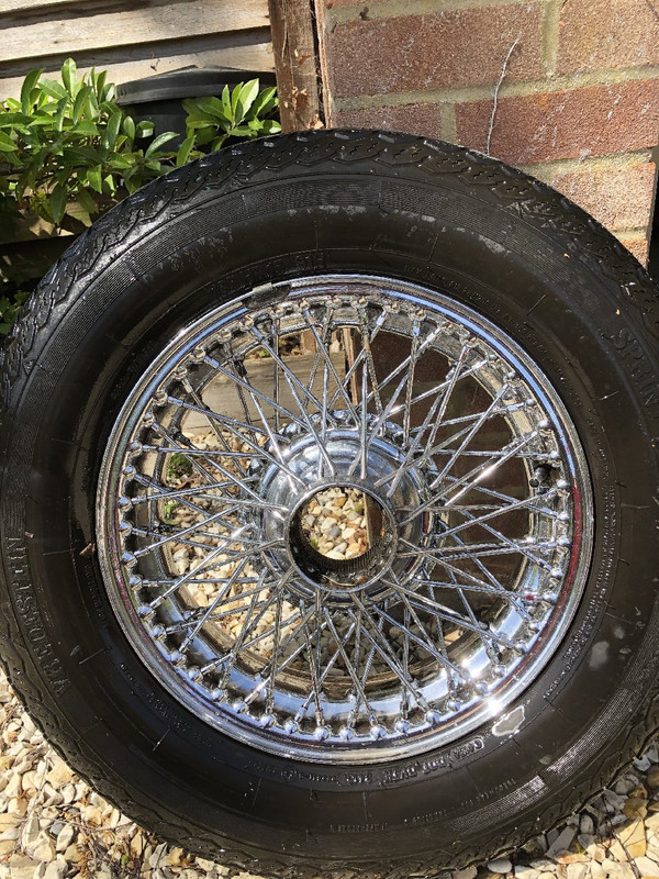

Couple of pics of my front wheel, before and after a quick 5 minute splosh with the MWS cleaning liquids

Jeremy, yes it does. You dab solution number one on with the supplied (or any other!) brush and leave it for 5 mins. This ensures it runs into all the tricky to get to corners. You then just hose it off and it comes up like magic. You let it dry, I rub off any "pooled" bits of water after a while, then apply diluted solution two which is a protective covering. This one, you don't hose off, just leave to dry. You sometimes get some light residue after drying, so just buff off.
It can be done with the wheels on, although best with them off so you can get to the backs. I do it once a year with wheels off, then just re-do when dirty with wheels on during the year. With wheels on, you can do all four in about 20 minutes/half an hour.
Once a year, with wheels off, I do also add some polishing on the main areas, and some carnauba wax.
The pictures in the photos above are with no polishing and no wax, just a 5 min before and after putting solution on and hosing off.

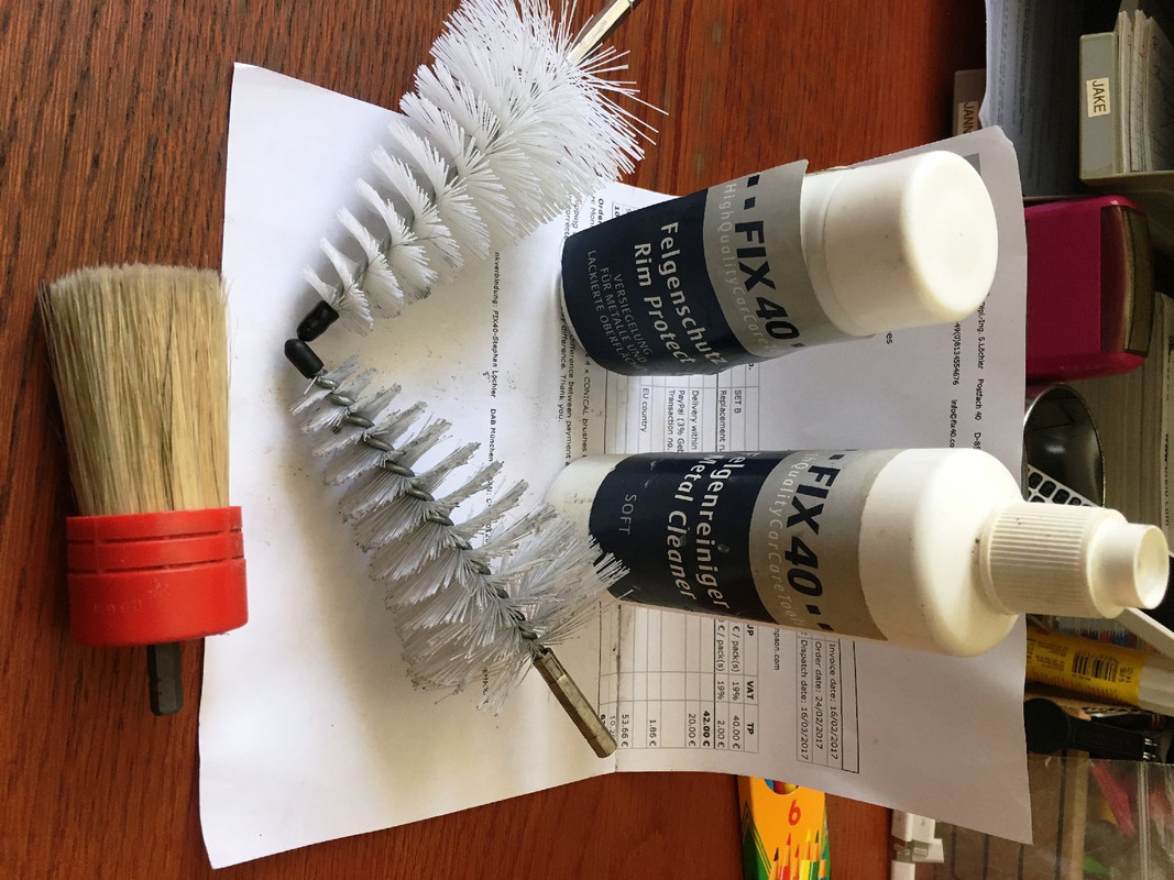

Vastly better than the Fix40 system that I was daft enough to try
viewtopic.php?f=9&t=2136&p=94619&hilit=fix40#p94619
where I never dared to pursue with the "RimProtect" as the manufacturer wouldn't tell me what it did or
what the effect was over time ................
......... nor accept any help to better-translate the crap instructions.
Funnily enough, they seem to have disappeared without a trace !
The conical brushes, however, used with a portable drill, were very good ............ anyone ever seen these on sale elsewhere ?

Like you Rory I bought the Fix40 stuff a couple of years ago but the lack of intelligible instructions and the rather brutal brushes discouraged me from getting into a long term relationship with it.
