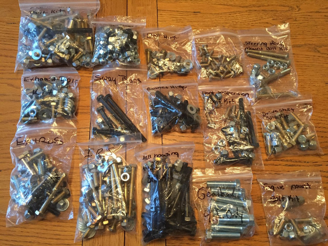

Chuck is the gent who runs this show:
http://www.monocoque-metalworks.com/main/
He sells sets of top quality fasteners...
I write as a happy (UK/EU) customer but with otherwise no connection.
Peter
EDIT: He's also forgotten more about how E-types are put together than most of us will ever know.

Post by rswaffie » Tue Oct 13, 2020 6:01 pm
Yep, I purchased one of his comprehensive kits.
I retained all the original non-high tensile Bees fasteners where they could been seen.

#8 Re: Nuts & Bolts
Post by Kember17 » Tue Oct 13, 2020 6:04 pm
They are exceedingly good value and, for quality, are the veritable mutt's in my opinion.

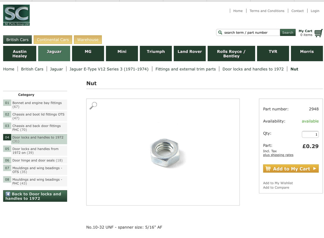

Post by Mephistopheles » Fri Oct 16, 2020 8:18 am
John, SC parts and Limora give detailed specs of bolts, nuts etc.
