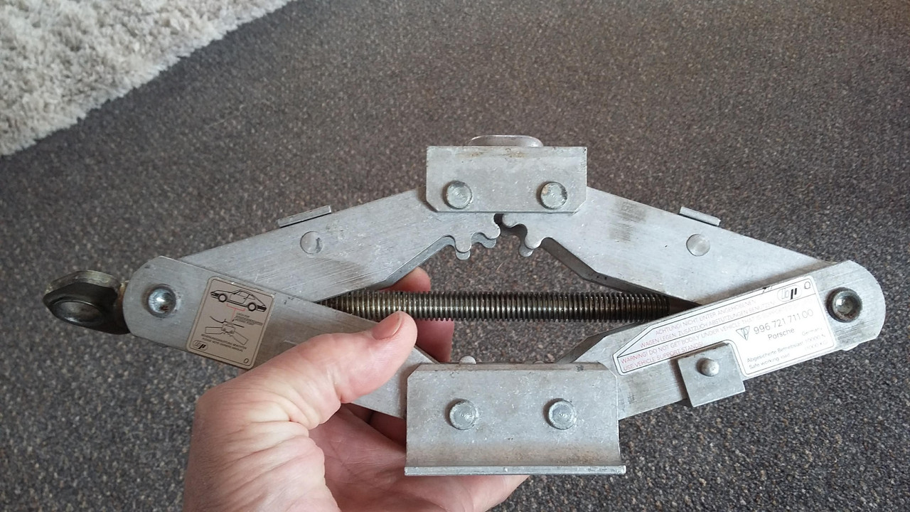

The only ones that will fit under the car when you have a flat is the Metallifacture one that was supplied with the car - available but £300+. There is however a better option and that is to buy a jack from a Porsche 944 turbo and file the oblong locating nub square. This is the one you want, labelled 'Porsche 944' and '944 turbo'; note long handle with black plastic hub on hooked end:
12.87 = date of manufacture and will vary:
File this to a square shape; width is OK but it is a bit too long:
A grand total 163,192 cars in the 944 family were produced between 1982 and 1991 so finding a jack should not be difficult. The jacks are works of art and you will not believe how light they are! Should be standard fit for all S1/2 cars that will be used. Usually available on eBay for between £35 and £65 depending on condition.
One of several on eBay at the moment: https://www.ebay.co.uk/itm/Porsche-944- ... SwxGBdKx0b
Telescopic bottle jacks will not fit so don't waste your money!

I should point out two things:
1. The Porsche jack is so strong you can use it to jack the car under any appropriate point the nub will safely fit. You can also adapt a rubber pad to fit the nub e.g.
2. There are two styles of Porsche 944 jack - one with the nub as described and the other with a slot in it:
This will obviously not fit the standard jacking point but you could use it on other suitable points like any other scissor jack. Still way better than a steel scissor jack because Porsche went for lightness - you can lift it with one finger.

Exactly my thoughts - just need a rubber or hardwood block that will fit onto the jack, and use it wherever it fits. It just needs to work for wheel changing.

The Porsche 928 jack works perfect if you can get one. Needs some filing as David suggested above, more compact and quite solid, lifts the E very easily (engineered for a heavier car with one lifting point on each side):
