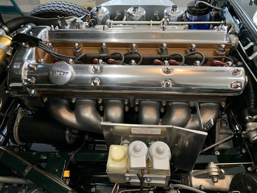

Four coats of High heat stove/BBQ paint later , lets see how long it lasts. A bit too much snow here right now to find out though.

Looks great. Did you do some sanding/smoothing before painting?

Tremclad , see picture. 350c Did a slight bit of smoothing , about a half hours worth. Just a dremel. If it lasts a year I will consider it a success and report back regardless.

I applied VHT header paint during my rebuild in 2013. It never looked glossy, but without any more applications, a quick buff with a terry cloth towel and it returns to its show ready satin finish. I would guess that VHT is essentially the same as BBQ paint, both being high heat tolerant.

Sperex exhaust manifold paint is quite good. You don't get the gloss finish Keith has got. It dries to a Matt finish but I did mine four years back and they are still not bad. I just wire brushed them clean and then three coats of paint about two hours apart (hot day). Might remove them when the garage is not frozen and just give a single coat for the new season but it has lasted very well.

I note on the Tremclad website it is 350c (as stated) for gloss and 650c for flat black. Most exhaust manifold paint is aimed at the higher end of the temperature spectrum and I've yet to find one that is gloss black. Your manifolds are likely to get considerably hotter than 350c in use (particularly when cruising at motorway speeds) so it will be interesting to hear how they fare.

Yep , two years later , there is little paint left on them. So next is VHT flat black and maybe a buff?.However I see VHT makes a semigloss ( read satin ) clear. I may do the flat , cure it ,buff, then satin, cure it and see if it will buff. I have tried silver VHT on my MG TD and looks great ten years and 15,000 miles later. Mind you the manifold of the 1250 four banger likely does not get quite as hot as the Jag's manifold. Snow is already thick outside and its off to the garage I go ! Just need to get wife out of the house for a few hours so I can sneak them into the oven for curing :salute:
