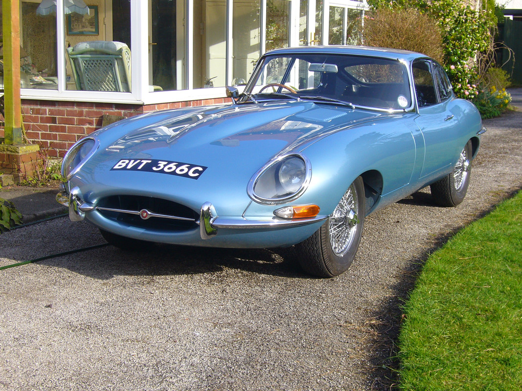

The S1 cars show a panel gap between the centre and side panels below the headlights, but the later cars with open headlights have this filled in.
Does anyone know the reason why?
Do any restorers leave the gap open on the later cars?
An open gap lets the sections be fully painted before assembly, but if the gap is filled the bonnet must be painted after assembly.
Any thoughts or comments would be interesting to read.
Edited to say that of course the bonnet must be assembled before painting to check the fit to the car. :oops:
Silly question but the above questions about why the gap is seen or not still stand.

Geoff : my S1 has the seam filled, as on top of the wing, with a short chrome bead . Or have I misunderstood the location you are referring to?
Last edited by christopher storey on Tue Apr 06, 2021 10:32 am, edited 1 time in total.
#5 Re: Bonnet panel gap
Post by christopher storey » Tue Apr 06, 2021 10:31 am
PS the strips, 2 per car, are BD19029/2 - the main strips are 19029/1
Last edited by christopher storey on Tue Apr 06, 2021 10:42 am, edited 1 time in total.
Posts: 3855
#6 Re: Bonnet panel gap
Post by Gfhug » Tue Apr 06, 2021 10:40 am
Hello Christopher
It's the gap below the headlight I'm referring to. On early cars you can see the join or piece of chrome, but is the chrome there on all early cars?
Sorry I've been editing this whilst you were responding
#7 Re: Bonnet panel gap
Post by christopher storey » Tue Apr 06, 2021 10:44 am
Geoff - see my PS re the part numbers. I don't however, know whether this applies to 3.8 bonnets, but I can see no reason why you cannot use the strips on 3.8, which obviate the neceessity of filling the gap
Posts: 3855
#8 Re: Bonnet panel gap
Post by Gfhug » Tue Apr 06, 2021 10:52 am
I can see what was looking like a gap in some (poor) photos is actually that short chrome strip. That now helps to explain one thing and Bill has nicely explained the change.
