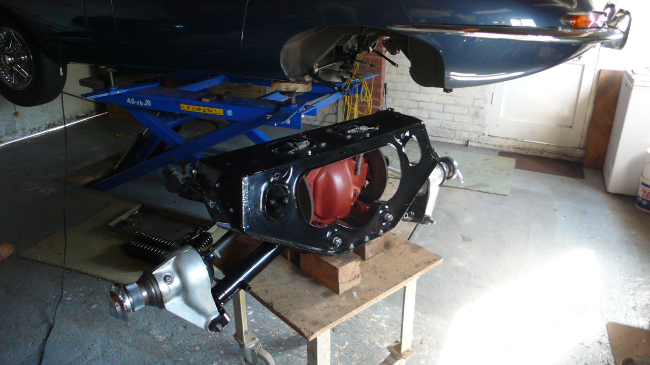

I have a scissor lift thats recessed into the floor of my garage. It's ideal for removing the rear axle complete and does have other benefits when working on suspension, brakes etc, but if I were buying now it would definitely be a two post ramp having used a friends to remove engine gearbox unit.

Removing the engine and gearbox using a 4 post lift is very straightforward. You just place a trolley underneath, disconnect everything and raise the car leaving the engine and gearbox on the trolley. Another advantage to this is that the bonnet and radiator can be left in situ.
I haven't removed the IRS yet, but using the jacking beam will raise the car sufficiently off the lift to allow the IRS to be removed-again onto a trolley which can then be rolled along the lift runners and on to the garage floor.
