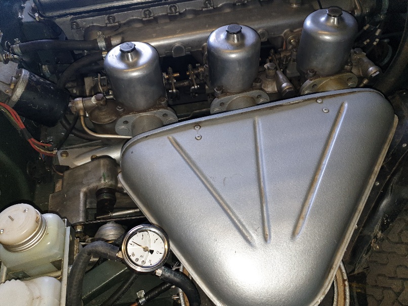

I put on a fuel pressure gauge today. 4psi on with the engine stationary, ignition on. 3.5 psi at idle. However, take the revs up and psi drops to nothing.
So I assume it is possible to have an SU fuel pump that makes pressure but doesn't provide enough volume?

I put the gauge between the filter and the carbs. The filter is new, the tank is new, the carbs are too!
Might take the filter out of the bowl.
The line looks OK and is new. Nothing I can see. Might have to blow down it see if their is resistance.
I get 4psi then, with a few revs it drops right down to zilch, which would explain why the engine is starving I suppose.

Why would you not expect the fuel pressure to drop?.....if youve tee,d the guage between filter and carb then with pump on you will see pressure.....but as soon as you open the end of the pipe the pressure will drop....which is whats happening when the needle valves are open almost continually on full throttle.....you should however still have plenty of flow from the pump to supply fuel....so long as the flow rate is ok.....Steve
