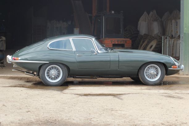

Evening Gents,
I was testing a 4.2 on Sunday and it kept packing up!
Looking for opinions prior to digging in at the weekend.
I starts and drives well, smooth and powerful. Sounds perfect.
However when large throttle openings are used, it goes onto 5 cylinders, then 2, then stops.
So you pull over, turn the ignition back on, then it starts normally and goes for a mile or two then all this repeats.
I put on a fuel pressure gauge today. 4psi on with the engine stationary, ignition on. 3.5 psi at idle. However, take the revs up and psi drops to nothing.
So I assume it is possible to have an SU fuel pump that makes pressure but doesn't provide enough volume?
