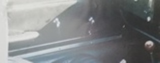

My series 1 2+2 has a 1 inch deep aluminium strip along the bottom edge of the door cards. It is held in place with csk self tappers.
I cannot find it in the parts book. Should t be there ?

I have found a photo of the aluminium strip on my car. Its just above sill level. I do remember seeing a car with something similar many years ago. The self tappers that hold it in place go through the door card and onto the door. Seems daft to me as there are clips to hold the card in place. Just something that was fitted by a previous owner when his card and clips became soggy?

Post by Stevejaguar » Sun May 02, 2021 11:16 am

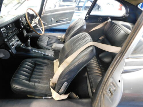

I have just had a look at 1966 JAGUAR E TYPE S1 2+2 MANUAL UK RHD on e-blag item no 254960290343 and the interior photos plainly show the ali strip, so I am not sure what the mystery is about them?

Hi Steve....this is a photo from the ebay add.....i can only see a chrome door trim....cant see an alloy trim on the bottom edge of the door card ....Steve

Hi all. I have the CHROME trim that is about 4 inches above the bottom of the door . I have the clips that hold it on.
If you look at the photo I posted you will see that there is an aluminium strip about 1 inch deep that is at the bottom of the door just above the sill. Its this one that I am querying.

Ahhh, your photo is not to clear Steve but now that you have said you have the chrome strip (Which is what I mistakenly thought you were talikng about) I can just see a light coloured strip that looks to me as if it is on the sill. because I have been researching a huge amount about the interior trim, looked at hundreds of photos, I believe (In my limited experience of E's) that the strip is unique to your car and my have been added by a P/O.
Definitely not a Jaguar part.
If I were going to put a metal kick strip on I'd do it up to the chrome bead, hot half and half,
