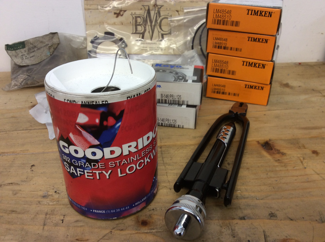

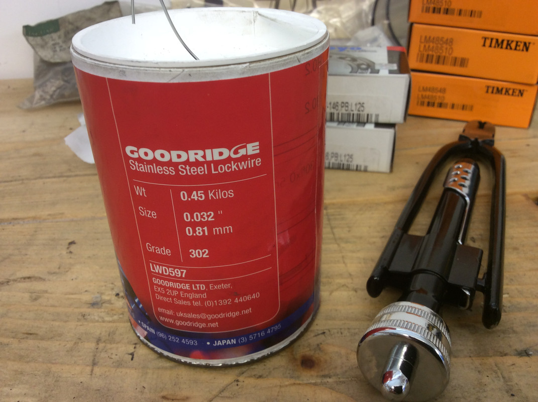

Hi Mike,
You don’t specify which bolt on the car you wish to lock. It generally would depend on what size and torque of fixing you are trying to lock to prevent them undoing.
0.025” is on the thin size to me, but it needs to be a good quality lock wire.
This what I use when working on E Type back axles and brakes which is 0.032”, which once properly spun up gives a nice overall diameter :-
Dave
