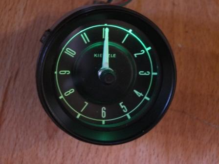

Hi, I'm hoping someone here can help with some information on E-Types.
I bought a couple of broken Kienzle electro-mechanical dashboard clocks (and repaired them), which I thought were all the same and all fit both Daimler DS420 and E-Type (I think series 3 V12). However, one odd one lights up blue for a white bulb in the back, whereas, the rest, and all the ones I can identify elsewhere, light up green.
In which case, I wonder whether the blue one is E-type and the green are for Daimlers, or there's some other uses of this particular style of Kienzle clock in a car with blue dashboard lighting, e.f. Rover or Ford. So I'm hoping someone can tell me what colour lights are used on the E-Type models.
DSCF5269 comp.JPG (25.33 KiB) Viewed 6189 times
This is one of the green ones - the blue one is still in paint and waiting for reassembly.
BTW, I've looked and swapping the plastic insert between clocks, i.e. taking a blue one out of a Rover/Ford, or a green one from a Triumph/Daimler, and that would be a difficult job. I haven't yet managed to get the hands off one of the clocks of this style yet, and it looks like a full disassembly of the clockwork movement or a level of brute force and massive ignorance I won't risk. So it would mean, at least, swapping the whole mechanism, and that would include the face, which is different from the all the Rover/Ford ones I've seen so far - though that only runs to about a dozen.
Also, I'm repairing these clocks because I had to learn how to repair the one in my 73 Dolomite Sprint, and making the tools and leaning how cost some time and effort and not a few failed attempts. So I'm doing what I can to put a few of the dead ones back into use, and try and recover some of my costs.

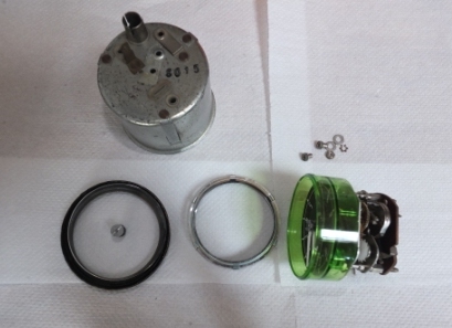

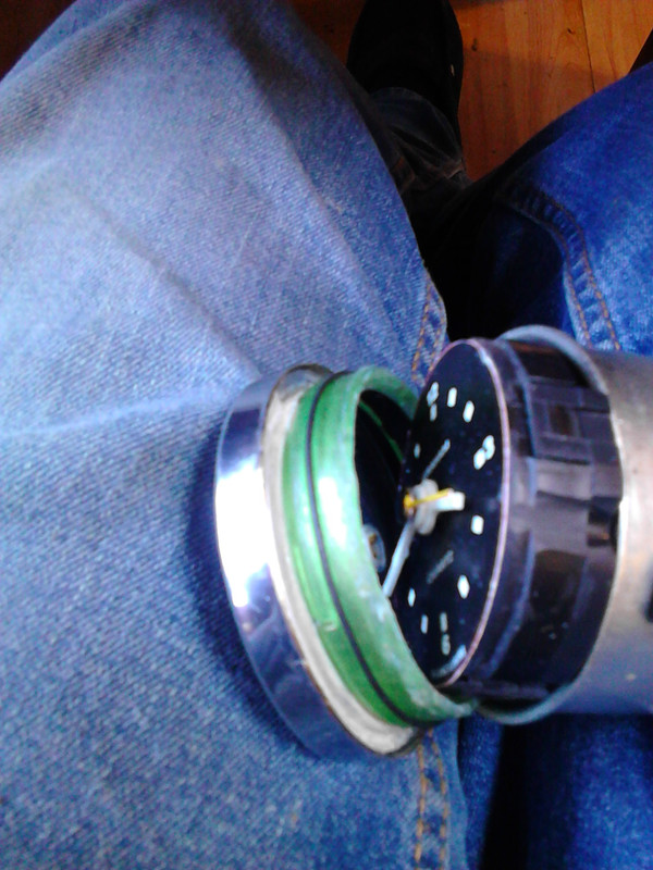

Took me a while to get to it - most of yesterday, I was up to me elbows upgrading a Herald dashboard to Vitesse like spec - but here's a picture of a disassembled Kienzle Model 8015:
The 8014 is the same, but the plastic is blue, and the 8013 also has a chrome bezel. I've s suspicion that 8012 might have a black and chrome bezel, but I know 8011 has a different face - and fits Ford Escorts. I'm looking for 8010 and 8016.
The mirrored ring in the middle is actually two parts, a flat ring and a conical pressing. Both are black from the front.
As said, it's the hands that hold the face and so the plastic insert to the mechanisms. An short of pulling them off with the smallest hub puller in the world, which I might try if I ever get a truly dead mech of this type, it looks like taking the electrics and the clockwork off from the back. And even then, it may mean swapping the front of the chassis and hands as well.
The difficult part in getting this far is taking the bezel off without the sides bending in or it splitting. There are a set of instructions on the Web for how to do that with a screwdriver and a vice that are virtually certain to end up with a knackered bezel, and possibly a working clock. I know, cos I followed them once.
Graham

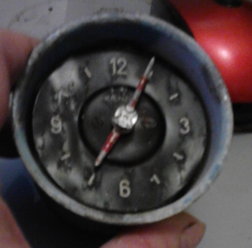

It probably is dirt in the movement then. They do seem to clean up well though. I even got this one stabilize for a clean and lube:
Just wish I knew what it was from, cos I've seen nothing quite like it, like a Rover P6 one but with the red hands.
The problem is in removing the bezel. That has to be unroved from the body with some care or it will split and or distort. The instructions that can be found on the Net are very bad and I think guaranteed to knacker it. If there are any over there, you could do as I did and get a couple of junkers out of Fords or the like, and practice. There are some available over here for £10-£15. I think it was worth it to me to repair the original one in my Sprint.

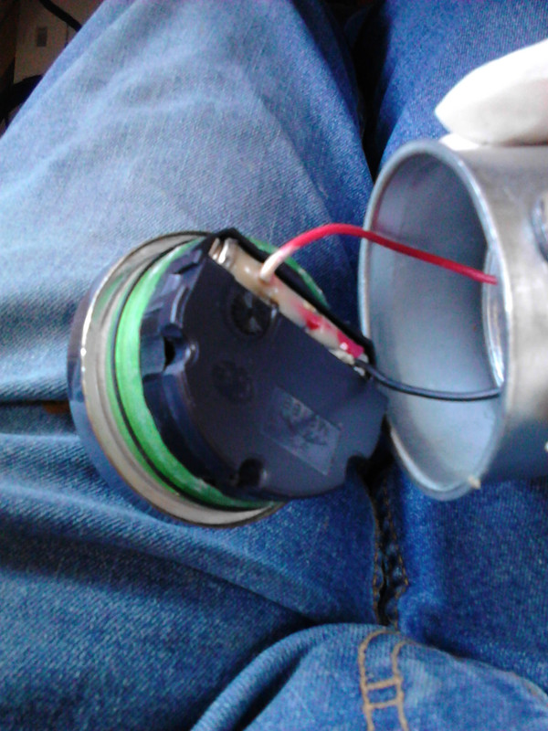

As to a quartz movement, this is a cheep solution, and can use a bezel that's a bit split:
The face is just a printed out and lacquered picture I drew, so can be anything - I saw a jpg of the 8013/4/5 face on line somewhere, but I can't find it again now.
The movement is a 65mm clock that was £2.50 ish from China, filed down to fit in a shortened plastic sleeve, with some of the back of the movement case cut away to let light through, and with a thin O-ring to hold it into the clock body. The knob that used to set the time, now glued in the glass, serves as a handle to pull it out to change the time from the back. I did have to make the hands from some scratch-modeller's plasticard, but it was like half an hours work with drill, saw, and file.
The replacement for the AAA battery is an old energizer cut up, inside which is two diodes in series, forward biased, with a 1k resistor up to the 12v supply. You can buy them, but they are surprising expensive for what they are.
The sleeve I used is from an 77 doly clock - nasty transistorized magneto-mechanical movement that didn't last well. But any one with the right colour sleeve and bezel will do.
