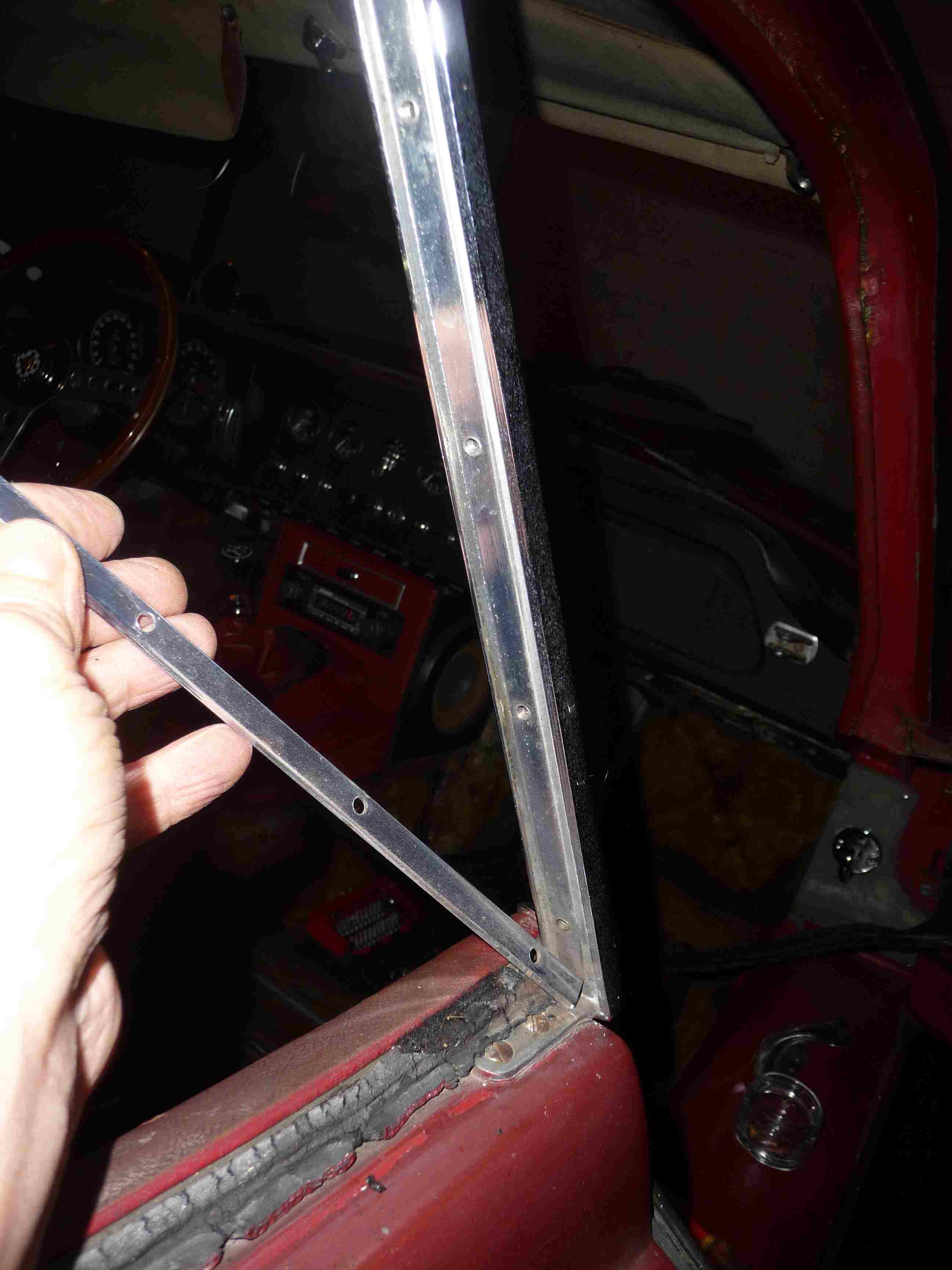

#3 Re: quarterlight window S2 S+2 Fell out - help please
A pic to help:

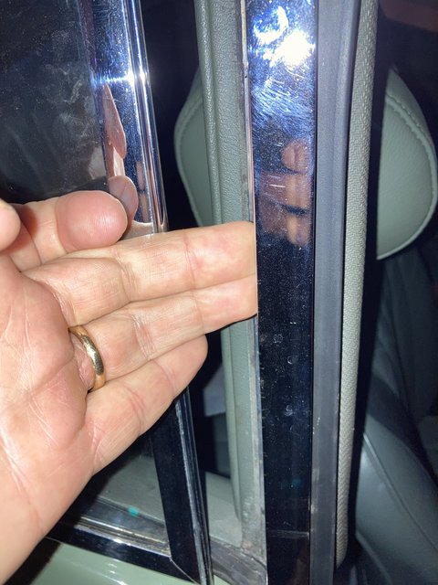

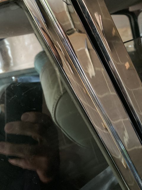

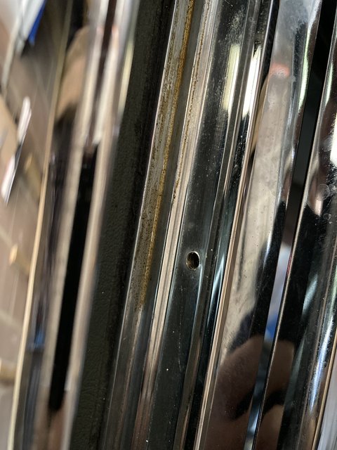

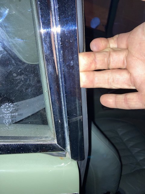

I really appreciate both of your bits of information and somehow my previous reply was lost. Anyway I have finally managed to get back to look at this matter and I’m pretty sure that I am missing the trim strip which should be screwed to hold the window in place.
I’m going to try to add some photographs which may make things clearer. With respect to the central chrome pillar which is just behind the door there seems to be a lip of about 5 mm making a recess where there is a rubber seal for the door to close against. Feeling on the rear side of the same chrome pillar the lip seems very much smaller and I’m assuming this is where the missing trim piece would provide more overlap to provide a hingeing mechanism for the rear quarter light.
If you think I’ve got this wrong then please let me know Otherwise I shall see if I can order the appropriate parts. I have a mosque catalogue and I think they’re calling it a quarter window hinge.
Once again many thanks for the kind help

#5 Re: quarterlight window S2 S+2 Fell out - help please
Yes, it looks like your are missing that part as shown in Serge's picture.
I'm not sure what the part number is for a 2+2 but it should be available or reasonably easy to replicate in brass and then get chromed.
The same part is used for both left and right pillars so you should be able to pop out the one on the opposite side to use as a template.
Good luck with your repair.
