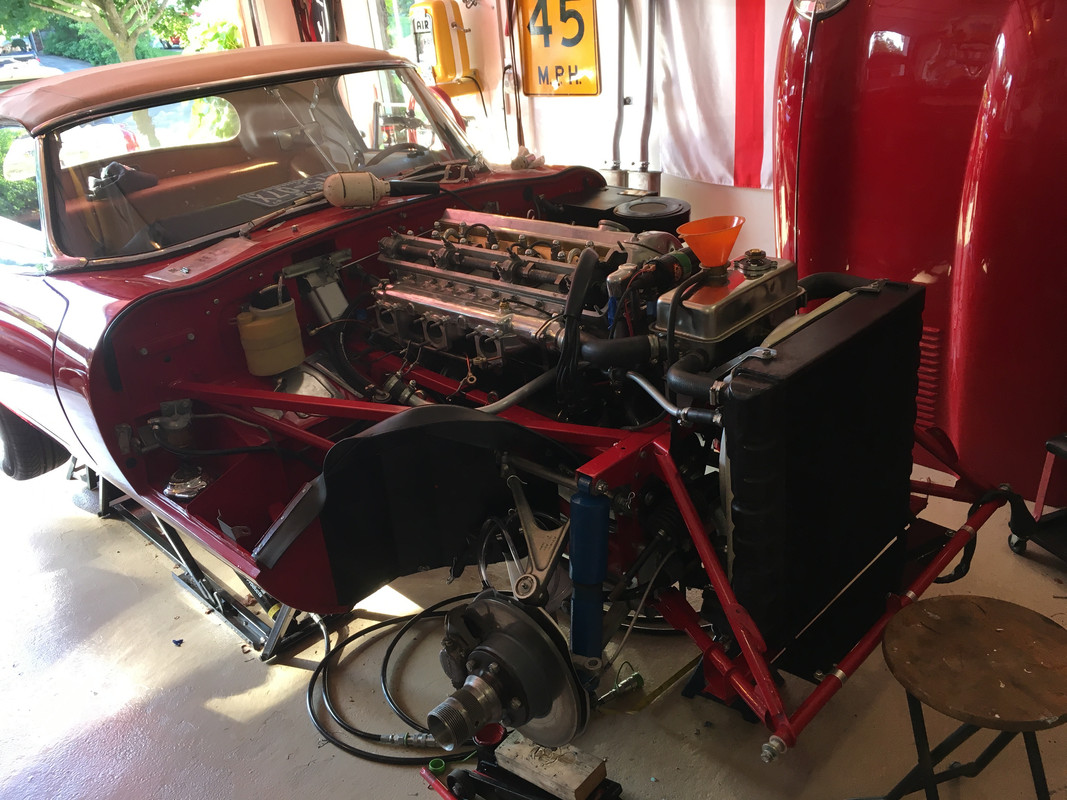

I have had one for four years now and used it numerous times. It has been great but is not perfect. It is barely long enough to reach the jacking points for the E-type, but a modification to the rubber support blocks and has worked fine with careful placement. Access is best from front and rear only. I believe max lift height is 22" but can be slightly less with the removal of one rubber lift block but not two per jack point
