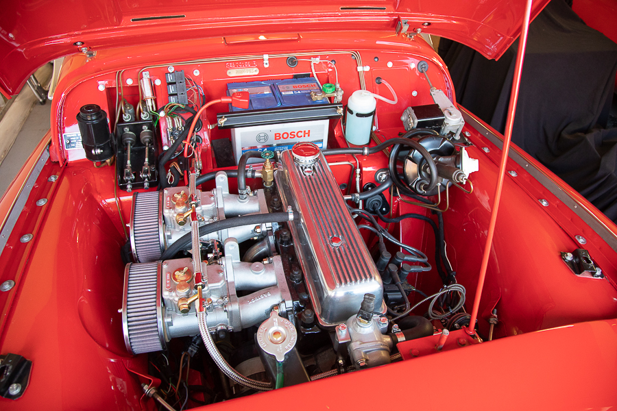

I have a Triumph TR3 running on Jenvey Heritage throttle bodies which resemble a Weber body.
https://store.jenvey.co.uk/throttle-bod ... itage-dcoe
Jenvey were considering producing their conversion with look a like SU bodies but as far as I'm aware haven't progressed that yet. These guys seem to have taken that route.
The TR with some head, cam and exhaust work together with 89mm diameter liner conversion, up from 86mm, showed 137.5 bhp on the rolling road. Drivability is amazing compared with the standard set-up.
