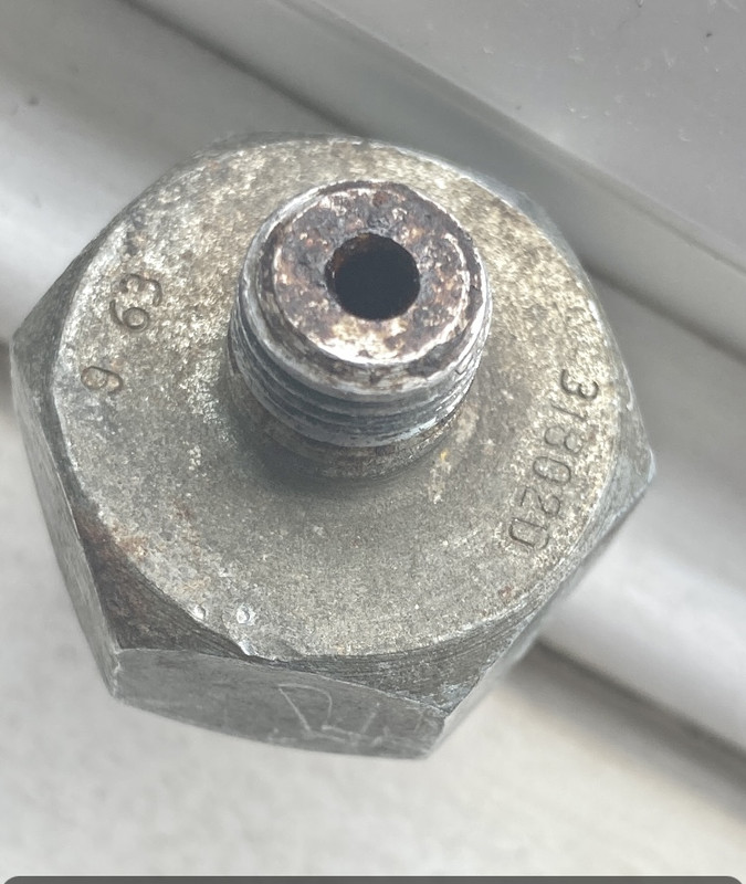

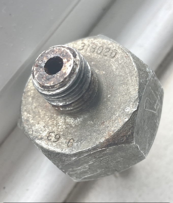

Hi all,
As mentioned in another post, my car performed faultlessly during the long weekend at the Goodwood Revival, apart from a brake light switch failure. I’ve purchased a couple of the ‘improved’ versions from SNG (one for my spares box in the boot). I swapped out the old one and the new one has sorted the problem. Looking at the old one, it seems to be an original Lucas item, with what looks like a date stamp of 9 63 which ties in with my 11 63 build date. Is this possibly the original switch? I run led brake and tail lamps so I suspect failure my be fluid ingress rather than burnt contacts.

Post by Heuer » Fri Sep 23, 2022 1:35 pm
Yes it is original Lucas. You may find CU- stamped on the side denoting it is copper. Suggest you consider installing a mechanical switch in the footwell as a) they are reliable and b) they operate the lights instantly. Simple to do and you can leave the stock one in place as a backup.
