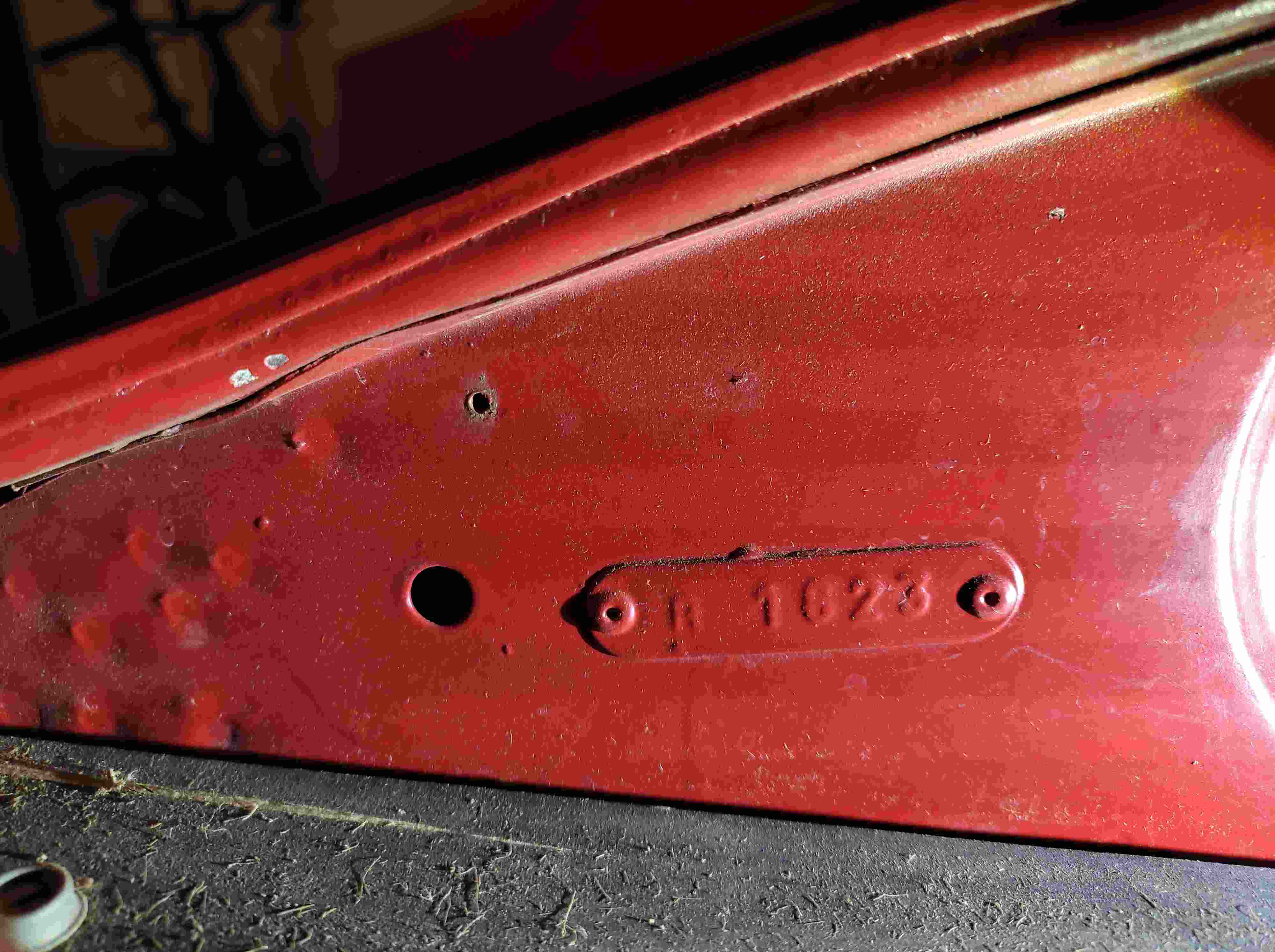

Post by paydase » Fri Oct 07, 2022 9:09 am
Thank you David.
The shift date would then be in September rather than October?
That would mean that the body of my 1961 OTS (#875740) was assembled in September 1961 at the latest, so earlier than the 10 October 1961 date of manufacture as stated in the JDHT Certificate.
Not surprising, considering the rather low (R1623) body tag number:
IMG_20220422_182719 (2).jpg (235.97 KiB) Viewed 3532 times
