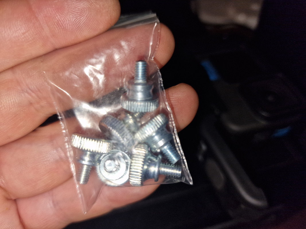

Thumb screws for legend strip

Hope they will fit.

#2 Re: Thumb screws for legend strip
Post by tim wood » Mon Oct 24, 2022 3:47 pm
They look the business.
Where did you get them from?

Post by gtjoey » Mon Oct 24, 2022 8:37 pm
Are they coarse thread like the original screw?
gtjoey1314
Posts: 1204
#8 Re: Thumb screws for legend strip
Post by DWW » Mon Oct 24, 2022 10:41 pm
They are M4 thread, one may have to re-tap the original threads. I will let you know once its done.

#9 Re: Thumb screws for legend strip
Post by Heuer » Tue Oct 25, 2022 8:39 am
There are no real threads in the instrument panel sheet metal, only those cut by the self tapping screws which may be all over the place if they have been inserted many times. Best to run a tap gently through but remember there is not much metal to bite into.

Post by DWW » Tue Oct 25, 2022 1:14 pm
Tried it but really on mine it requires tapping. Had to order a bit cause my 4 mm is missing from the kit…

Post by bitsobrits » Tue Oct 25, 2022 5:34 pm
I used #8 nutserts when installing thumbscrews on my car years ago. It does require drilling out the screw hole to fit the insert.

#12 Re: Thumb screws for legend strip
Post by DWW » Tue Oct 25, 2022 5:59 pm
Good idea, might try this if tapping doesn’t work.

S1 - normally secured with four self tapping screws but for this application we only need to use the two outer holes.
S2 uses a spring clip to secure the indicator strip.

Post by DWW » Wed Oct 26, 2022 3:36 pm
Tried the re-tapping method its ok but not brilliant. Ordered some 4mm rivnuts to turn it into a proper job.

Post by Mich7920 » Wed Oct 26, 2022 4:54 pm
It's a pity you didn't buy the ones with the black plastic head.
They become totally invisible when mounted.

Post by gtjoey » Wed Oct 26, 2022 4:58 pm
I just used a second pair of the dash ones with the black knobs...

"It's a pity you didn't buy the ones with the black plastic head.
They become totally invisible when mounted."
These are small enough to disappear in the under dash darkness :bigrin:
