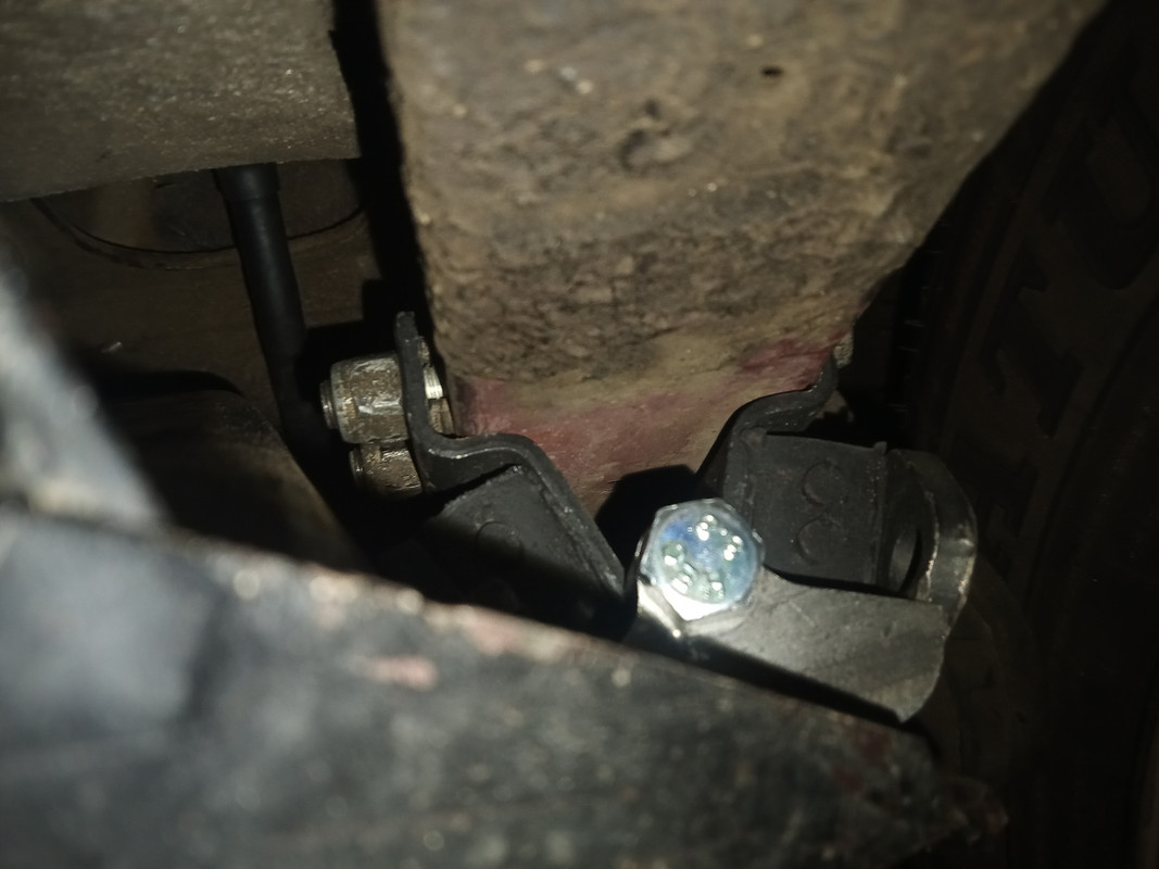

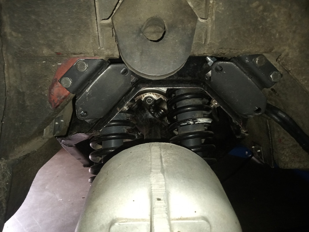

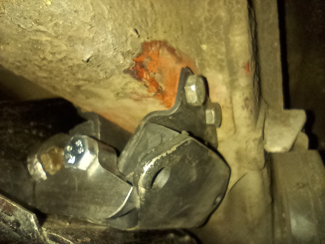

Paul, I made a few extra sets of these tools that are for sale. Designed to facilitate IRS installation; can also be used to protect the mounts against having to unnaturally support the weight of the IRS when the wheels are off the ground; avoids the need for props or other supports that could get in the way. You can read all about it in this thread:
viewtopic.php?f=3&t=20307&p=168220&hili ... ts#p167750
Steve – yes, if the mounts fail while the wheels are in the air, if everything is still connected the damage may not be significant, in which case the only consequence would be, you would have to remove the IRS to replace the mounts.
It’s what happened to me. After the car had been on the hoist for years :sad: I noticed by chance that one mount had torn through. it was obviously a relatively recent failure because the tear was fresh looking. Nothing had dropped noticeably, still 3 mounts holding, there was no other damage, just this one (old) mount. Still the IRS then had to come back out.
The tool protects the mounts and thereby everything else as well. For this service I fit the tool while the weight of the car is still on the suspension, while the mount is normally compressed. The tool locks the mount into this compressed state, even when the wheels are off the ground. You can see in my photos; these are the larger (modified CAC3067) mounts supporting the weight of the IRS while the car is on the hoist, wheels off the ground. Still, they are compressed; you can see that the rubber is rectangular and bulging.

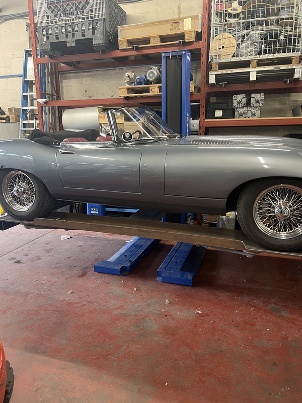

Its only taken over a year but she's up on the single post lift, had to bite the bullet in the end and fabricate a frame for car to sit on and sockets underneath for the lift to locate onto. I just couldn't get the spread of the arms to where I was happy with.

I've added weights at the rear end of the fabrication to balance the car out, even with the bonnet up. The actual lifting pads are virtually under each wheel. I've had it fully up you can walk underneath and it seems fine. May put some sort of jack in if I'm doing any major work. The lift is rated at 2500kgs so I'm well within the limit, the lift i have is a 24v portable lift from Automotech.
