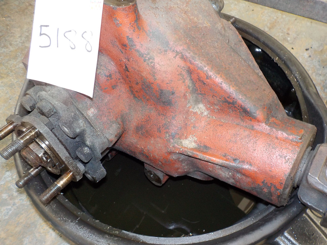

Weren’t the early diffs red?

Yes, the diff and its housing were painted with an orangey substance called Glyptol. It is still available , made, I think by Bombardier in Canada

Yes..... Photo below of our 3.8 Diff when it came out of the car for its IRS rebuild:

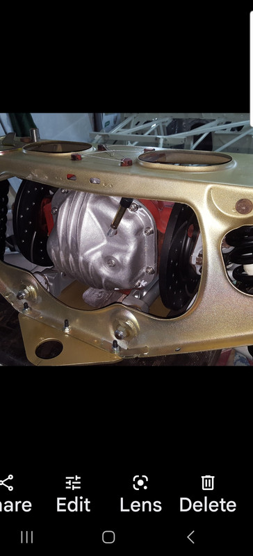

Hi when I built my car I did two things to the irs cage , 1 cleaned up the very old dodgy original welds and made the seam welds better and longer , especially as I knew I would be giving the car some stick , and 2 I had it cadmium coated in the yellow gold colour, i never paint stressed / structural items black , you can't see cracks in black
