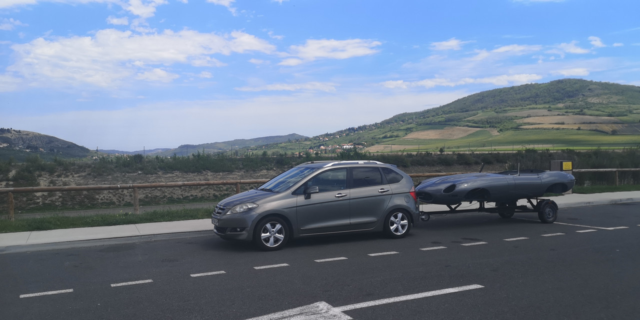

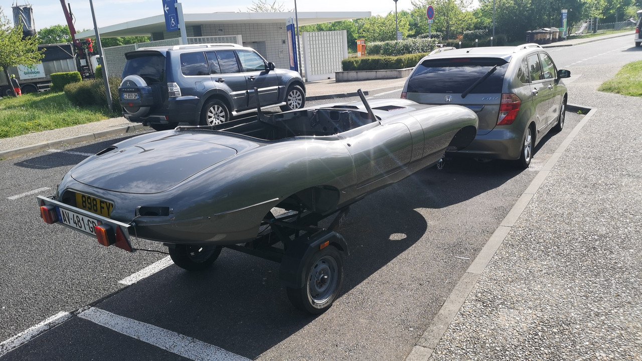

Having made various intrusions into the Forum about paint colour,
viewtopic.php?f=2&t=18854&p=156314#p156314
choosing between LHD-RHD,
viewtopic.php?f=2&t=18743&p=151878#p151878
and including such gems as
finding two migrants hiding under the tarp just before boarding the ferry at Ouistreham, I'm pleased to report back.

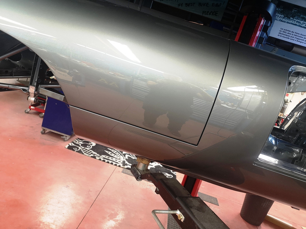

The car is now Opalescent Silver Grey, tho' of the Angus Moss variety, which appears to my eye to be halfway between the generally-accepted Opalescent Silver Grey and the Opalescent Gunmetal Grey, and it has a slight green tinge .............. so if the waters have been muddied, blame Angus.

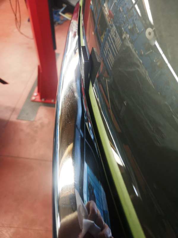

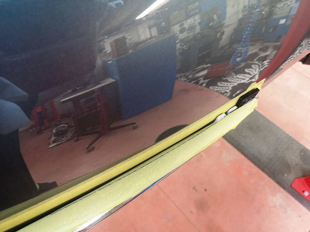

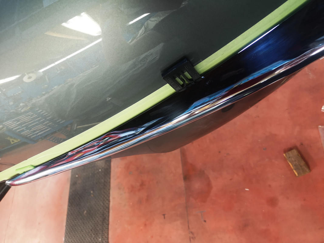

I'm starting on the rewarding, if frustrating and repetitive, task of adjusting the rear chromes, just to remind me what a 9/16 AF spanner feels like after all these years.
I thought they were pretty good when I took the car to bits, but now that I've got a Hollywood paint-job I'm condemned to reproducing all the rest to match :scratchheadyellow:

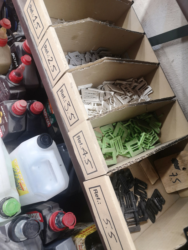

Anyone looking for really useful shims (designed for sliding over fixings in the building trade, for window-and-door-mounting adjustment) could do worse to find a source of these, mine are trade-name Goettgens - I must have used them on dozens of mechanical projects over the decades.
They're also useful to set standards - my ISO9001 norm for bumper-to-body gap is now the 5.5mm shim :bigrin:
For anyone who is faced with this kind of adjustment for the first time, a curved-section flap-wheel (as opposed to the common flat-type) works really well, with regular wet-rag application to cool the steel, when removing metal from the edges.
These new cordless DeWalt grinders are a major improvement over my previous corded ones - lighter, stop quicker, would never have thought these attributes would make such a difference.
What chance have I got of being able to re-create these Hutson shut-lines once the engine is installed ?!
