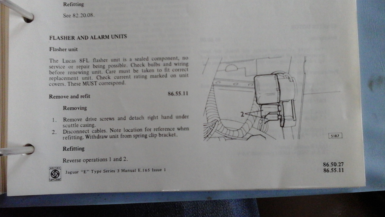

#3 Re: Flasher unit, hazard flasher unit
Tony I’ve checked behind the centre instrument cluster just now which I’ve checked before, no flasher of any description there.
Directly under the glove box is covered with the air con unit so no access to above.
I see your list of cars do not include a series 3 , I think there is a difference. What I’ve found out so far is if I remove the top of the dash I can then get access to both flasher units mounted at the side of the glovebox.
If anyone has removed their dashtop I could do with knowing how they did it.

#8 Re: Flasher unit, hazard flasher unit
Thank you Marek, crystal clear.
