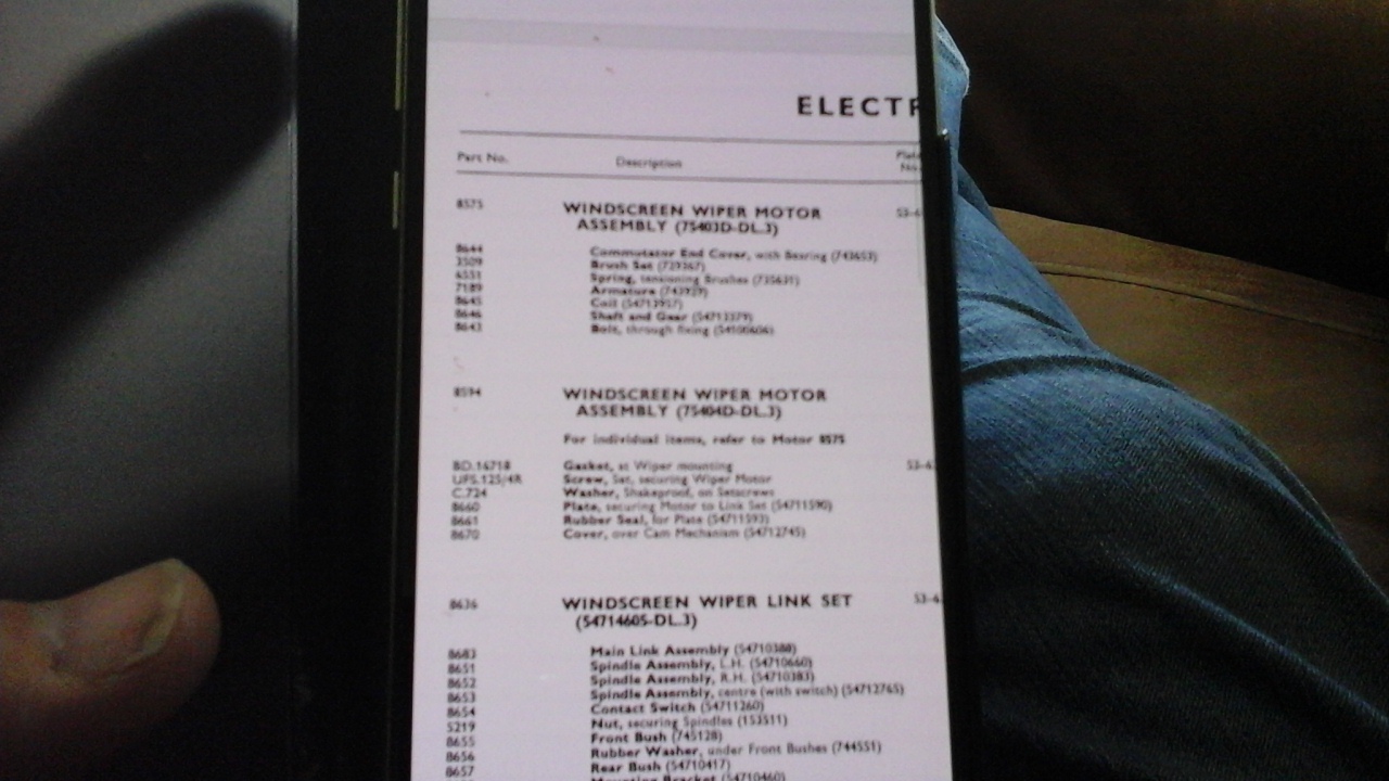

Does it give a part number?....i dont actually know what bolt your refering to but here is the parts list..bolt 8643.....screw securing wiper motor UFS.125/4R havent looked through everything...sorry photo is blurred

Nope! Just the drawing.

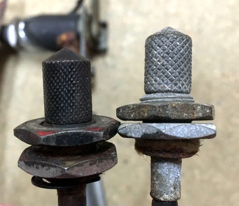

Sorry I did mean the thin nut, you are right. On the end of the adjuster there are these two thin nuts to secure the assembly to the firewall. I am missing the outer one.

Danny, I’m looking for that same locking nut for the firewall wiper adjustment cable.
Can you tell me under what criteria you found it on Ebay, please ?
I forgot to measure the TPI before I poked it through, so the visible threads make it difficult to be categorical, but it’s either 1/2” x 24 TPI or alternatively 26 TPI.
Former is visibly a “Brass Thread” and second is a Cycle pitch, my hunch is it’s that.
Be nice to find a correct thin nut with the double chamfer.
Any observations / suggestions very welcome.

The reward for hoarding odd nuts for 40+ years in a drawer marked "Cycle, various" is :
It's 1/2" x 26 TPI or Cycle Thread.
Too thick to be credible, and not plated, but it's a start.
UPDATE : Found this, with UK shipping £6.34 ........... do I need it that badly ??? :scratchheadyellow:

Danny, if you could perhaps Edit your original post so the title reads
Wiper Adjustment Locknut on firewall, 1/2" x 26 TPI Cycle
then I think it will change the title on all the following replies, and make it easier for someone else to search for ?

Same principle, Steve, but not - unfortunately - the same kind of nut, nor the same thread.
