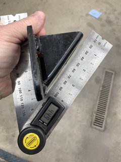

#7 Re: 4.2 engine physical dimensions
Post by mxke » Sat Dec 28, 2024 7:09 pm
Looks like 45 degrees
