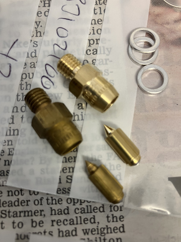

Sometimes small issues can actually turn out to be small items causing the problem.
In September last year before I put the E Type away for winter, I had a similar annoying intermittent issue appear which I initially viewed as a misfire, but in reality the consequential misfire was really a starting issue. As the car gets started infrequently, sometimes the car would start and run perfectly and other times, I would roll the car out of the garage for it to misfire and not run correctly.
As I had believed it to be a misfire, I went through and replaced all the usuals - new plugs, distributor cap, rotor arm, leads, coil - I even sent the electronic ignition back for testing. Eventually, I realised it was not electrical, but fuel related, as initially it was cylinders 1 and 2 misbehaving, followed by also the next two cylinders of 3 and 4, so it could not be the ignition.
Having checked the fuel pump filter and delivery, plus the bulkhead and carburettor filters, plus stripped the carb to clear out all the jets, normal service was resumed - until I tried to start the car after a few days when the misfire reappeared.
To cut a long story short, eventually I traced it to the float bowl inlet needle valves being worn after my 20 years plus ownership of the car. Perhaps one of the smallest components on the car, yet these were either sticking in the valve bores or not sealing on the valve seats to give me incorrect float bowl levels and hence the misfire.
I do run triple Weber carburettors, but the principle of checking these on SU carburettors could well apply as such small items can cause major issues - and frustrations !
Old and new inlet needle valves :-

Apart from the obvious wear of the needle, it seems that the used bore is larger.
Is it an optical artefact?

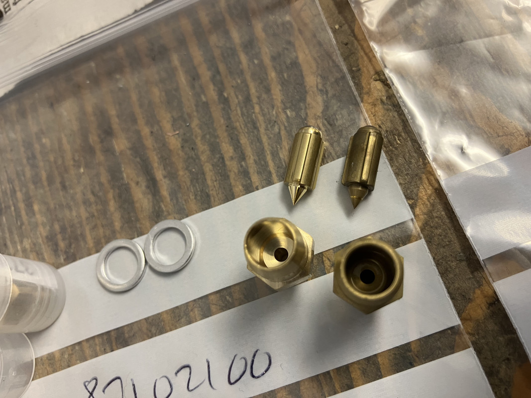

Hi Serge,
No, it must be an optical illusion as both the old and new have a bore of 6.5mm where the needle taper point slider fits.
Interestingly, with Webers there is a range of Needle valves of differing diameters in the seating area which are used depending on the fuel consumption rates and for fuels containing alcohols. I use 2.00 mm needles.
Another point made in the Weber literature is that the needle taper point and seat are finished and checked as a pair and are not interchangeable with respective parts of other valves. The needle valves can be damaged by engine vibrations and car motions if the float chamber is empty, so in the case of sports cars transported on trucks, they recommend that carburettor bowls should be filled with thin engine oil for proper protection.
A selection of Weber Needle valves :-
