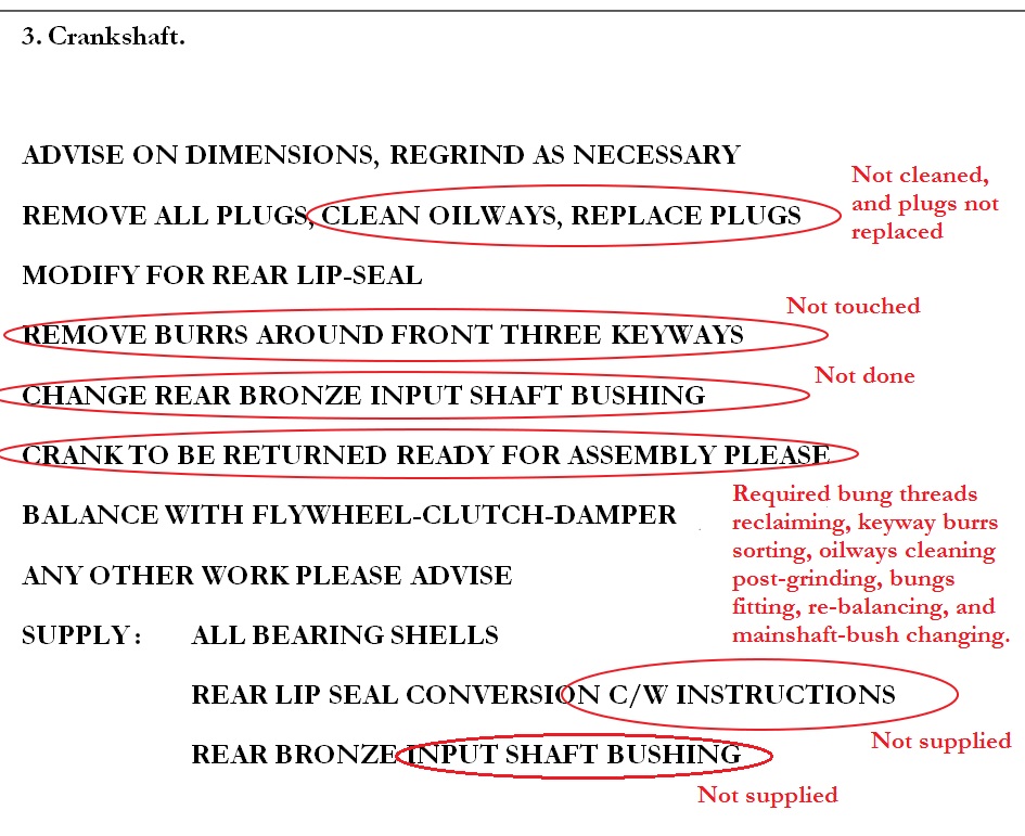

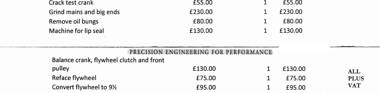

rfs1957
Posts: 1593
Location: Languedoc - France
#3 Re: Warning given, advice useful.
Post by rfs1957 » Thu Oct 03, 2024 7:57 pm
Very sorry to hear how hopeless your friend's engine builder was.
Brings me right back to my experiences with Chesman.
I quote, an extract from this :
posting.php?mode=edit&f=2&p=108803
I'm working towards a YouTube video detailing everything that was cocked up by these people, thus pulling into one place the kind of questions that any putative customer should be discussing with an engine-builder or a machine-shop.
I had no idea that firms as poor and hopeless as the one I dealt with existed, and would have been far more careful if I had believed that when I bothered to write a job-sheet as detailed as this, for example, they would essentially not read it :
Their invoice seemed to suggest that they had understood what I was asking
but essentially they have no system in place to track a customer's requirements, and are visibly not interested in the slightest in the detail quality of the work they do.
Yet this is PRECISION ENGINEERING FOR PERFORMANCE, you'll note.
The upside for me was that I didn't pay for an assembled engine, and discovered their horrors in time ; so I was able to correct them all, and - happily - can report that so far MY engine (not theirs) is really good.
