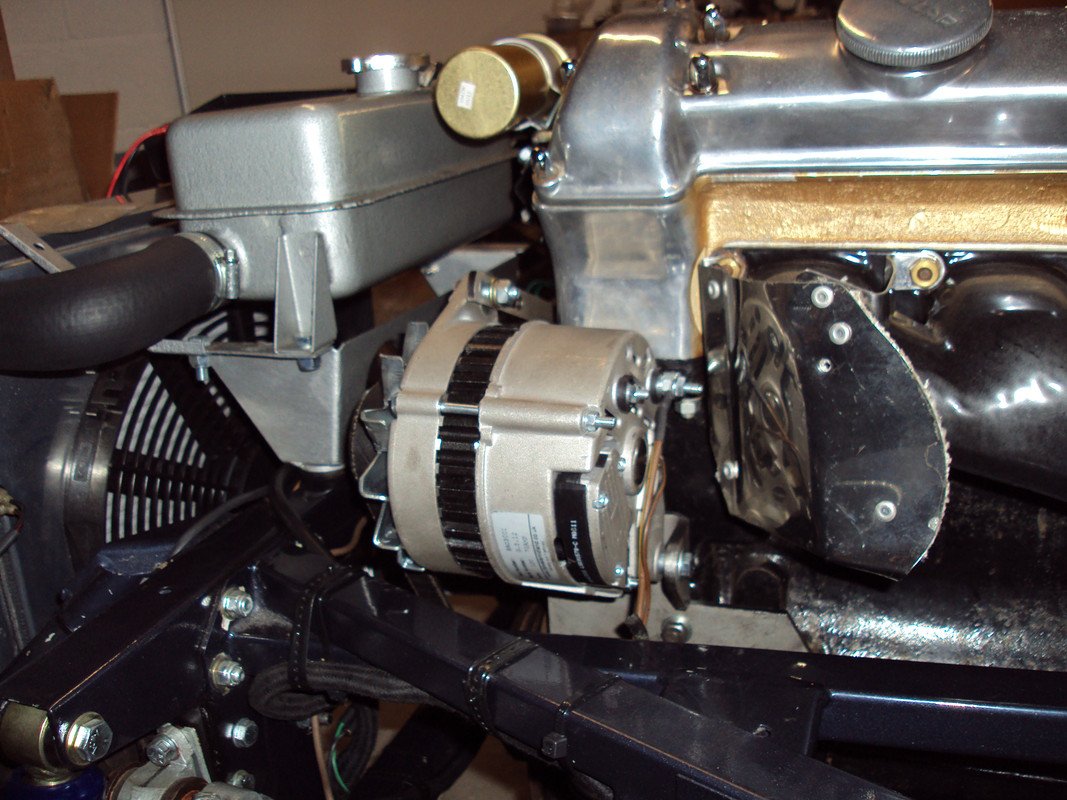

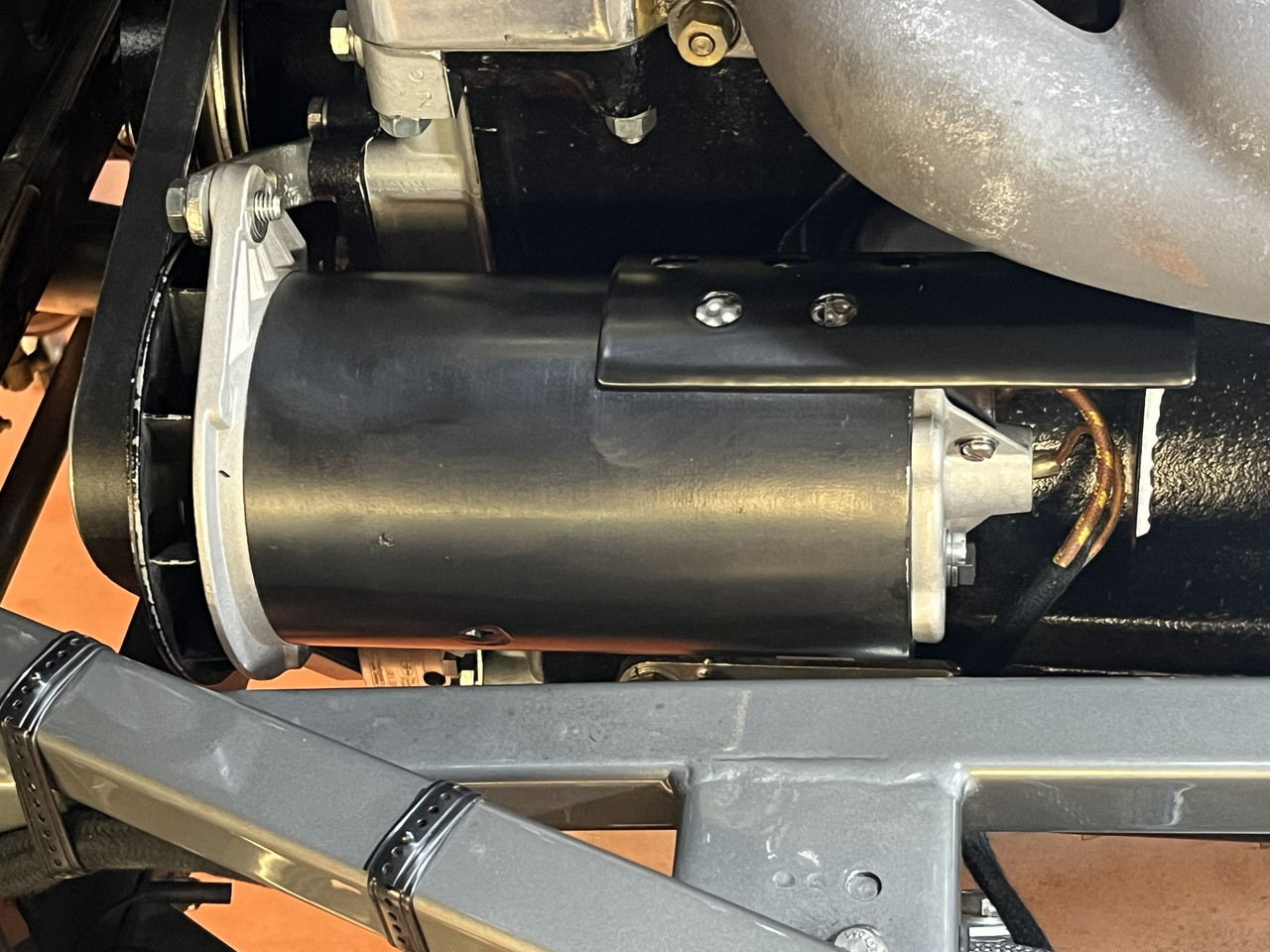

Is there any point installing one on an S1 3.8 with an alternator conversion as they never were supplied from factory?
#2 Re: Alternator heat shield

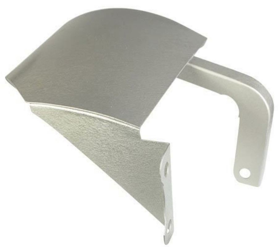

I put in the simple stainless shield that goes between the manifold and rear if the Alternator.
Note that the REAR of the alternator is the INTAKE and the front fan pulls air from the rear through the alternator and out the front. So the rear shield at least breaks the direct radiation.
If your talking about the larger nacelle type shield over the top I think that's more of a safety protection shield for the belt and pulley.

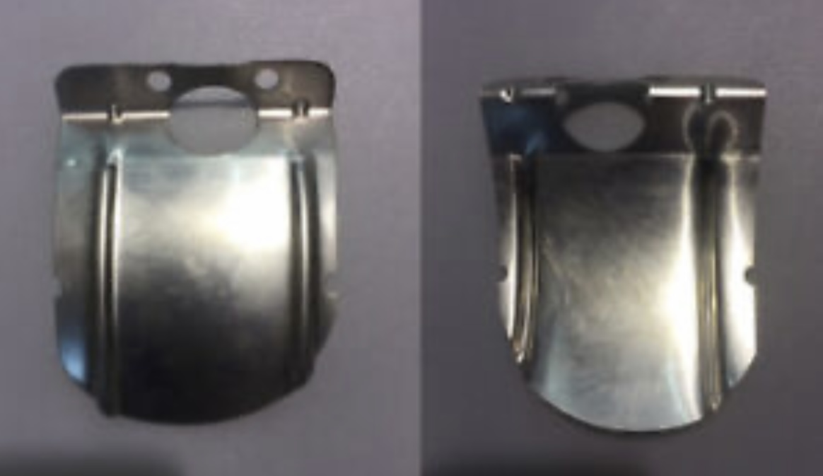

#3 Re: Alternator heat shield
#4 Re: Alternator heat shield
That's like the one I used.

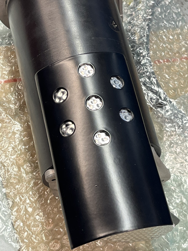

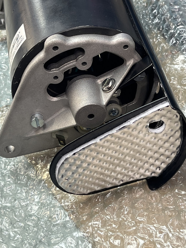

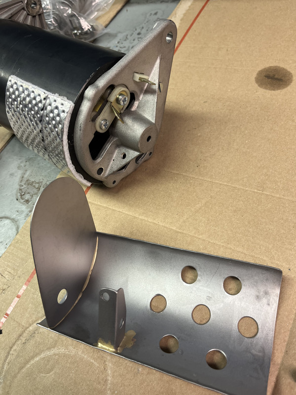

#5 Re: Alternator heat shield

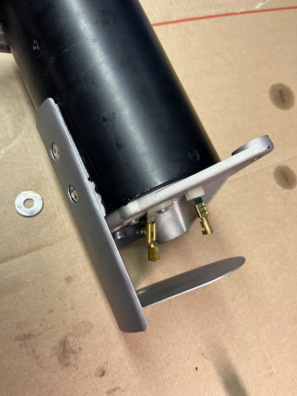

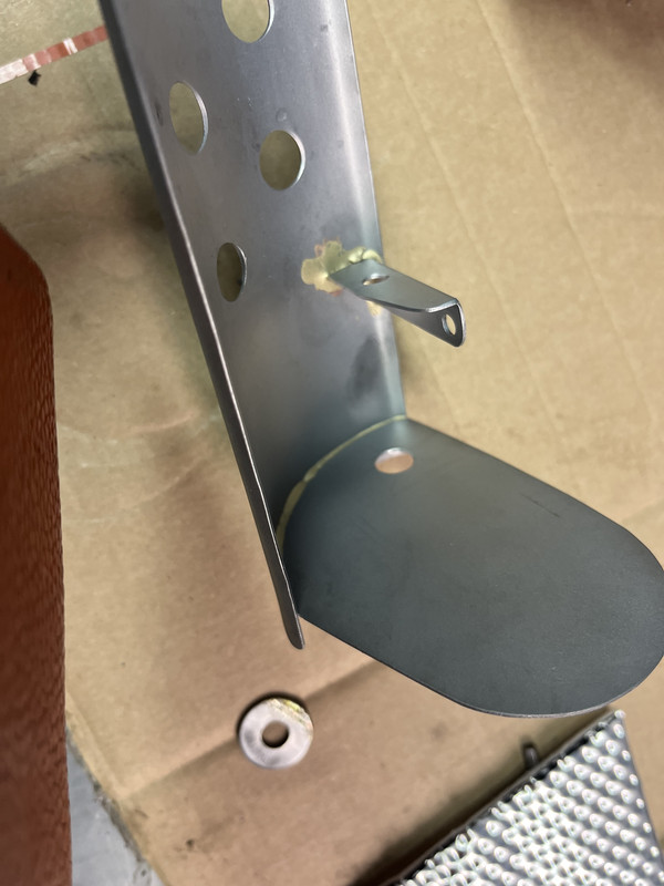

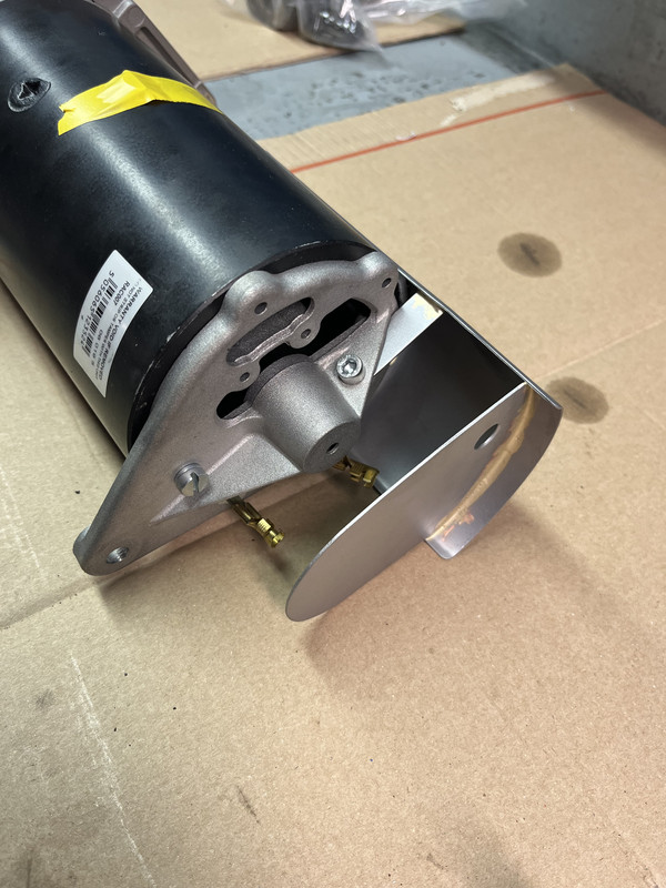

I made one for my 3.8 using 0.7mm stainless steel sheet and rivetted some fibreglass thermal matting to the back.
It was more for preventing radiant heat transfer when stationary but allowing airflow when on the move. I remember thinking that the factory 4.2 item appeared pretty ineffectual for radiant heat.

Good idea. Ugly but likely effective. Functionality wins, may put it on the projects list.

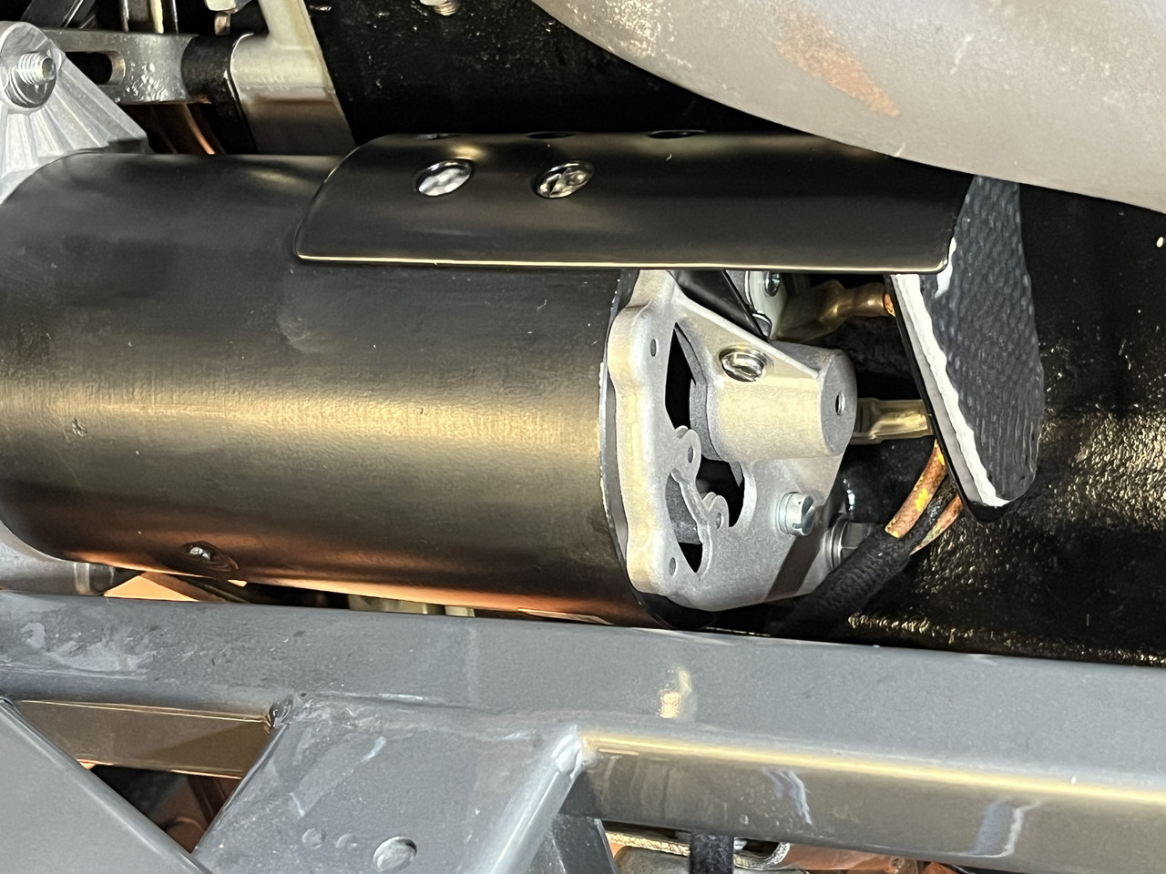

Ordered from Martin Rubey.
#9 Re: Alternator heat shield
Installed today looks like it means business

S2, a slightly tidier appearance....more pleasing to the eye.

The larger shield doesn't really do anything for heat as far as I can see. More of a "safety" shield I think. The simple stainless one shields the rear air intake of the Alternator from the exhaust manifold heat, somewhat anyway. The added shielding added by Series1 Stu does an even better job.

Geoff, It never was correct. On these and most alternators air flow is back to front. The fan in front PULLs air from the rear of the alternator, through and out the front. Seems counter intuitive I know but that's the way they work. Common misconception.
That's why the shield between the exhaust manifold and the rear of the alternator makes sense and the top shield is a cosmetic or safety shield that leaves the rear completely exposed to the exhaust manifold heat. Might even make the alternator hotter when at a stop by enclosing it and not letting heat radiate off, don't know.
