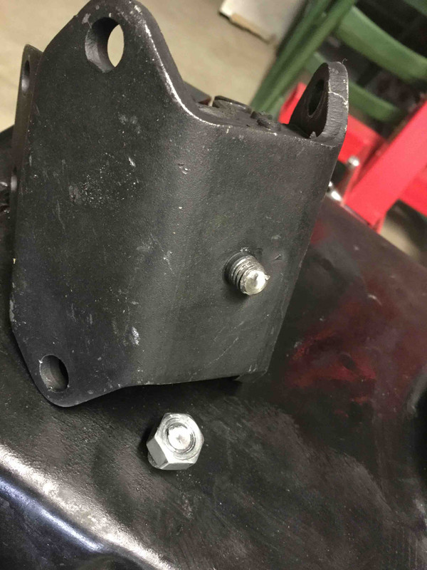

I had a breakage of one of the IRS V-mounting screw when tightening it to the cage. A bit annoying for a new part, and one that secures the IRS to the car :scratchheadyellow:
I am pleased to report that SNG will send me a new one with no discussion :bouncyyellow:

Now that I can load pictures again, here is a photo of mine after stud break:
I can assess that I tightened it to the official torque, 21 N.m, not more :mad:

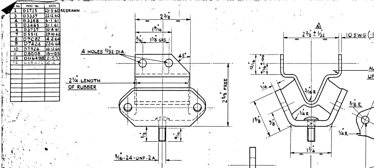

Here is the original design drawing:
There are essentially two designs, original and upgraded. They both fit however the upgraded version is murderously difficult to install without a special tool that makes it a cinch.
Read all about it in this old post:
viewtopic.php?f=3&t=20307&hilit=IRS+mounts

I can assess that I fitted the new mount with no trouble to my original IRS cage.
And I succeeded in assembling the whole IRS to the tub with no issue, including the radius arms which only required a slight pressure on the rubbers to fit on their bowls under the floors.
What I cannot assess thought is the strength of the new mount studs. Wait and see... :fingerscrossed:
