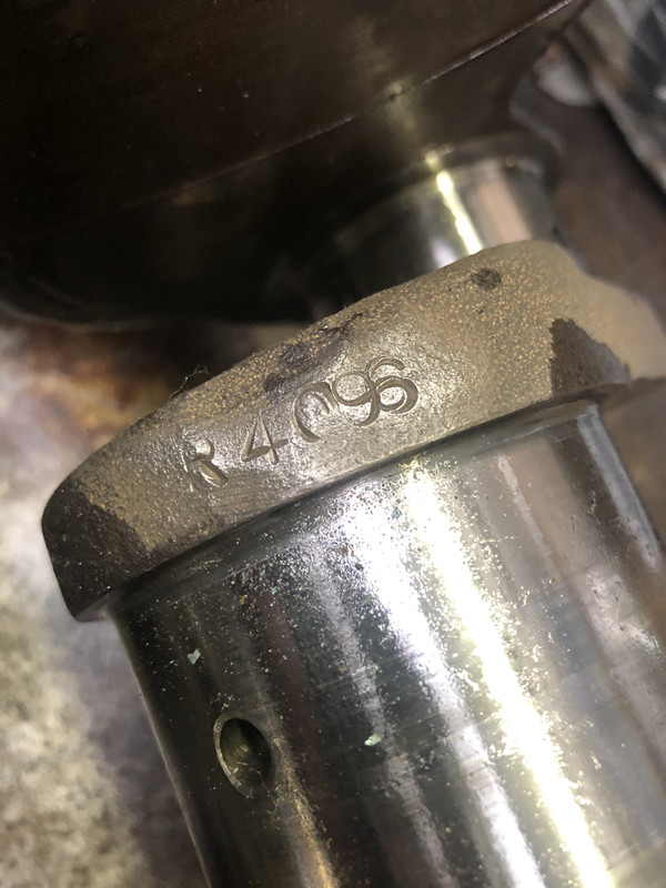

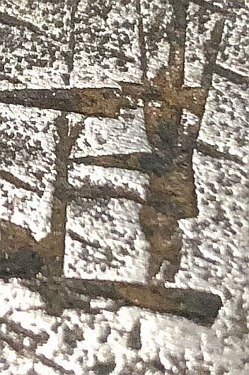

just dismantling my March 1962 RHD 3.8 OTS engine for rebuild
Engine number is hard to make out on block but I read it as R 4095-9 although the 5 is hard to make out clearly! This is what is on the heritage certificate.
The crank has R4096 stamped on one end
I looked at the block and it COULD be 4096 ??
Is it possible that the factory ledger was written incorrectly?? It would seem odd to be the next number along as the engine numbers don’t generally follow in sequence with the cars??
See photos
Any views
Robbie

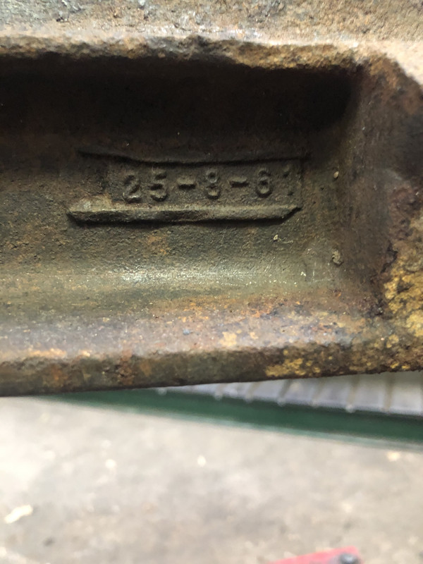

Block build date.
Smooth sump
.see photos
Robbie

Hi Robbie...a hand written 5 can easily be mistaken for a 6 or visa virsa.....i think i have seen Heuer (David)...use some photo imaging to enhance numbers that would be good to use on your block....Steve
Posts: 4106
#6 Re: Engine number
Post by abowie » Wed Oct 07, 2020 7:10 pm
I wasn't aware that cranks were stamped with the engine number by the factory, and the font of the stamping looks different to normal. I'd wonder if it's been done to identify the crank by a later mechanic.
It's odd that someone has tried to obscure the stamp on the block with chisel marks.
I have an image of the ledger entry for one of my cars; as David says the handwriting can be pretty poor.
Personally I'd ignore the stamping on the crank and go with what the certificate says.
PS to my eye the number on your block is a 6.

Someone clearly wanted to hide or obscure the identity of the block. Those chisel marks are not accidental!
There are ways of raising the numbers which are used by Police to identify guns but chemicals are involved. One easy to try method is to rub a graphite (lead) pencil over the area and see if it bring the numbers up more clearly.
Robbiee
Posts: 714
Location: Derbyshire
#18 Re: Engine number
Post by Robbiee » Thu Oct 08, 2020 11:16 am
Yes that’s my impression..but the number does seem to be the same as the crank number!
I’ll try the graphite but maybe contact jag heritage to check the number
I think it’s best to get it sorted and above board as I wouldn’t want to be guilty of having a fraudulent number!
I don’t think the engine not being matching really matters to me ..I’d rather it was just confirmed as being the actual number. After all the heads were often repacked anyway as on mine!

The chisel marks are odd because although directly on the digits it has not made the number totally unreadable ,there are also lighter chisel marks around the number !
So , could it be someone being very rough has tried removing the seized on cylinder head in situ by hammering a bar in that area whilst hanging all the weight by the head ?, are there any similar marks on the other side of the block ?.
