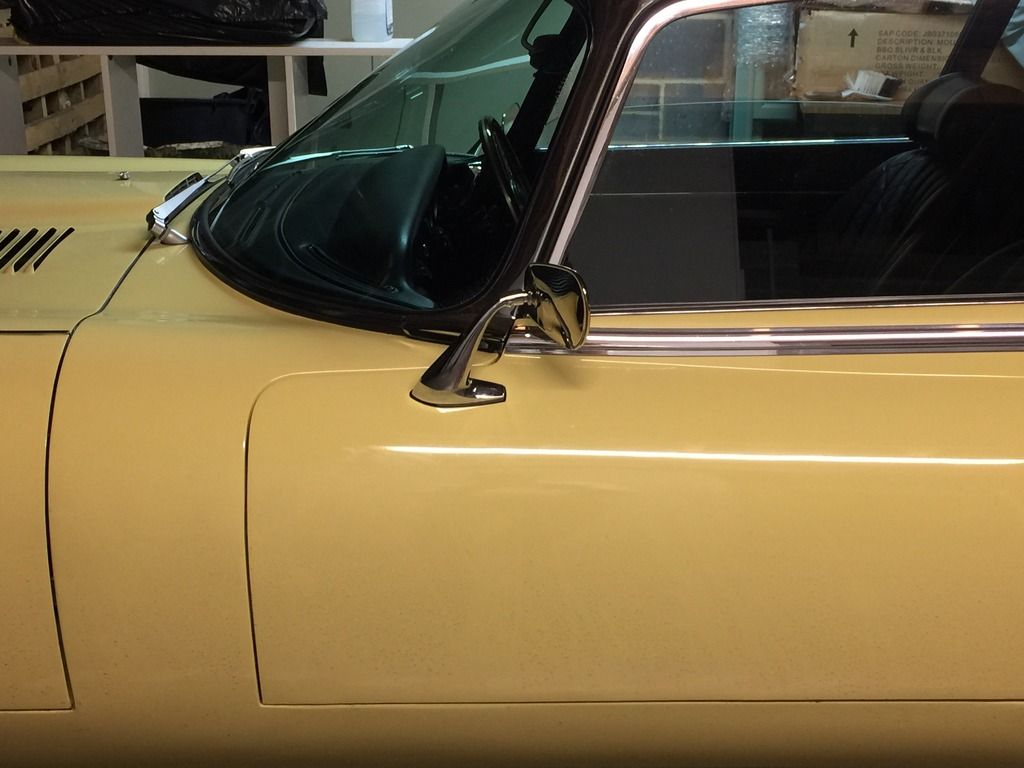

#1 Door mirrors
My good lady insisted I fit a nearside mirror before she'd take to the wheel so despite my opinion that mirrors spoil the look of an E-type I've caved in to her request. Other than being sure to fit it symmetrically with the one on the other side, is there a secret to installing one or is it just bish bash bosh with the cordless and in go the screws?

Don't just assume that the placement should be the same on the passengers side... you may end up with the Pillar between the NDV and the window right in the middle of the line of sight. (Been there, done that)

Fair comment, although it would alarm me to see them asymmetrical. Maybe I'll have a few trials holding it with some duck tape first. In the garage that is.

#6
It appears you have bought the SNG Barratt units, which, after a lot of research, I decided were the only ones of this style you can fit and actually see out of. There are several similar designs which just don't seem to work, as you can't get them to line up. They also look very clumsy, whereas the SNG units seem very close to originals I found and actually look quite graceful, with swan like necks.
If your mirrors are not SNG type, then be very careful indeed as I suspect you may be very unhappy when you do drill the car door and ruin the paint, yet can't see out of the mirrors when fitted.
If they are SNG type, then I am fairly confident you can fit them satisfactorily to both doors, but as pointed out, be sure that the same position on both doors works from the drivers' side. I suggest taping the doors with masking tape and getting someone to trial position the mirrors in several locations and choose the best, symmetrical location, whilst you sit in the driver's seat.
I would like to help with exact locations, but by the time I had found the SNG versions would work, I had bought new, clip on units which remain fitted, with no drilling. My conviction the SNG units will work is based on the fact I can get their heads in a similar position to those of my clip ons, which are excellent until you do a prolonged very high speed run.

The masking tape will also help with location when drilling if you want the best chance of avoiding slippage.

#7
Thanks for all your input folks. It is indeed an SNG Barratt mirror and appears to be virtually identical to the one (originally?) fitted on the driver's door, see the first photo. I ended up fitting the additional mirror about 40mm rearwards of the existing one, (same height though) to minimise the obscuring effect of the A pillar.
I squirted some oil into the freshly drilled holes, cleaned off the paintwork, and then smeared some sillicone grease to the underside of the black plastic shim to try and prevent water ingress. It felt uncomfortable yet strangely liberating to be drilling through the paintwork and door skin.
Oh by the way, the car is the same colour on both sides, and all over as it happens. Must be a trick of the light.
