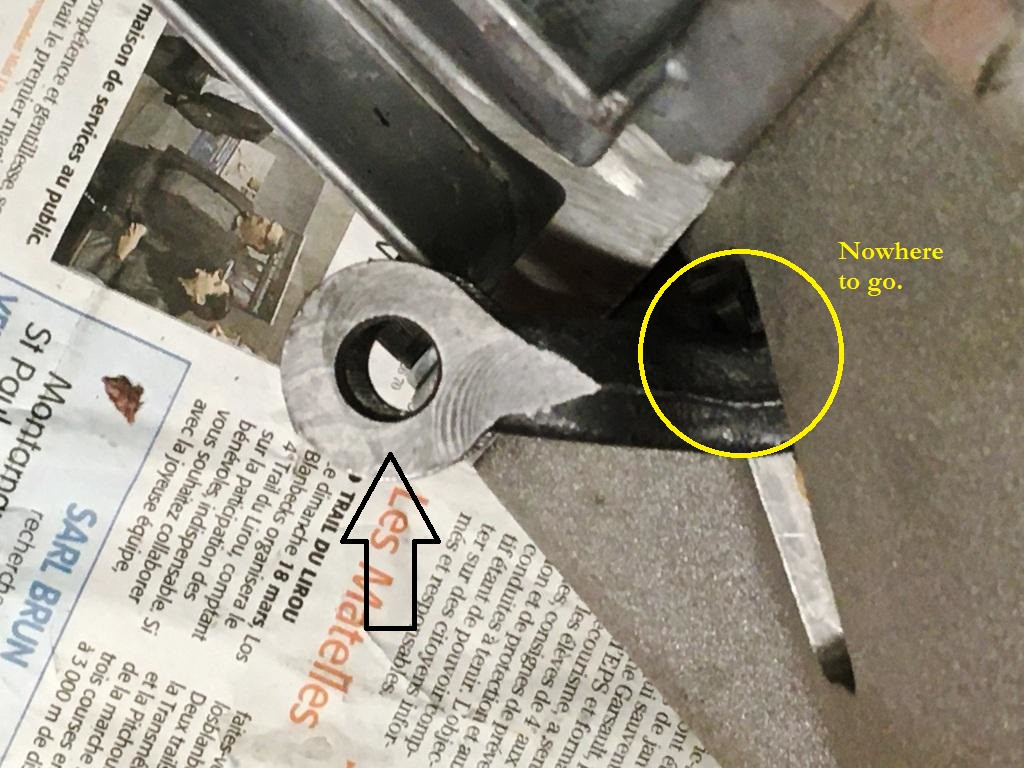

Now that I have come to fit these elements, I have hit a problem that I am sure I have seen referred to on the Forum before, although perhaps - in my case - it's with a twist.

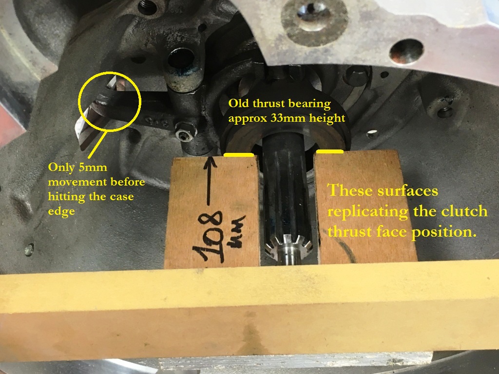

Everything assembles correctly, but now when I fit the bell-housing I discover that the release fork and bearing run out of space to operate, even before the bearing begins to push on the clutch.

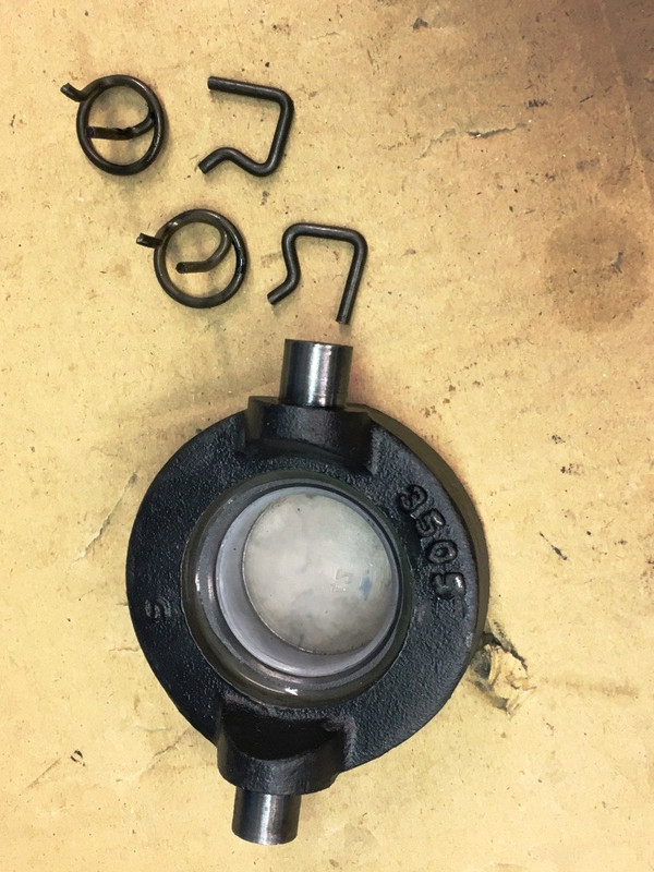

Now, the new release bearing I've been supplied is about 6mm thinner than the original, which is obviously wrong.
Should it in fact be much thicker ? It would have to be about 10mm thicker than the original to optimise the available movement of the operating arm, which seems unlikely ?
The release fork is a new one, but appears to be identical to the one it replaced.
Do the two clutches use the same release fork ?
There is about 25mm of movement available at the thrust face, measured from maximum-withdrawal (where the clips on the release bearing hit the back of the bell-housing) seen here -
which equates to this, seen from the outside -
to maximum-advance (where the operating lever strikes the window in the bell-housing) seen here -
equating to this seen, from the outside -
but the thrust face is barely touching the clutch centre at this point.
So the whole thing is about 20mm wrong, a mismatch that is so massive that there must be some glaring clue somewhere in these pictures ?

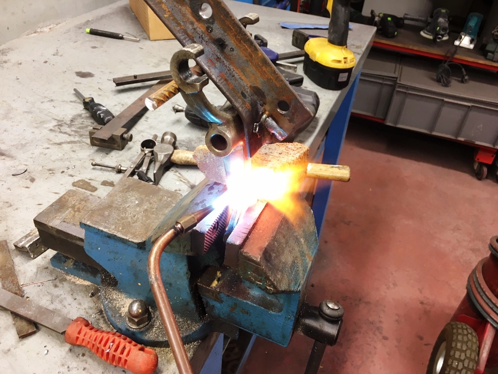

Your simplest solutions is to bend the end of the fork.....its been done many times amongst the guys im in touch with building C types...where mixing various Jag parts is very common....Hope this helps some...Steve

Replace the release bearing with a carbon face that sits higher or cheaper still, bend the fork as Steve suggests (with heat a ruler and a hammer).

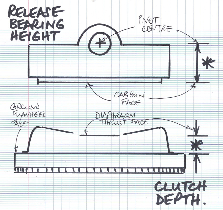

Agreeing on how we're measuring is important.
My old release bearing has a height of 32mm, which I'd guess is a worn version of Steve's 35mm.
My new one is 25mm, which is obviously a dud, so there's 10mm to be gained with just an original.
My new clutch depth is 50.5mm, so everything sounds good there.
The rough ratio of the release fork is 100/60.
So the 10mm gained on the release is worth 16mm of movement at the piston.

Hi Rory...yes measurements are as per your drawings....the differences in the release bearings isnt becaus of original vs aftermarket...there are 4 different "thickness" ones that iv seen....could be others....think it will be down to part numbers...but you would have to trawl through the parts catalogue then find the part and measure it...Steve

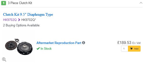

SNGB list the Borg and Beck clutch kit as in stock. Personally I'd just send back what you've been sold and use one of theirs.

From what I can see from parts books, and with help from Simon at Precision Clutch, these ought to be the parts we're looking at.
Caveat : see post #20 from Steve3.8, what follows is at least partially inaccurate
From the XK120 to the XJ6, all manual cars used the same clutch release fork, reference C9797.
All 10" Spring-Clutch cars, until the 4.2 in 1965, used a release bearing referred to as 2590 and 48443 (in the J30 parts book) ; these are substituted for the HD3306 by SNGB, which looks like a Borg and Beck reference.
However, I think the actual B+B reference is HD3317 ; I believe this is the "lower" thrust bearing with a 25mm height as defined by the earlier drawing. (Apparently also used in MGB ?).
All the 9.5" Diaphragm-Clutch cars, including the XJ6, used the C23575 release bearing, which became C23575/1 in 1968,
https://www.terrysjag.com/E_Type_Series ... Clutch.pdf
which was slightly (??) thicker, then C23575/2 in 1970, which was the same size but different material - all of which are interchangeable. C22478 must have been in the mix at some point, too, as Andrew says.
These bearings are now Borg and Beck HD3319, and the height is about 35mm (will confirm).

Height of new old stock release bearing (Quinton Hazell) = 34mm measured as your drawing.
Height of diaphagm pad to flywheel face using clamped Borg and Beck NOS clutch plate = 55mm

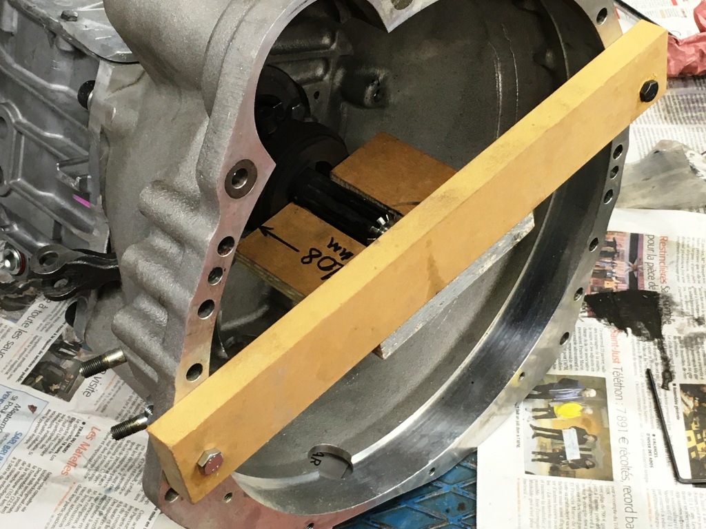

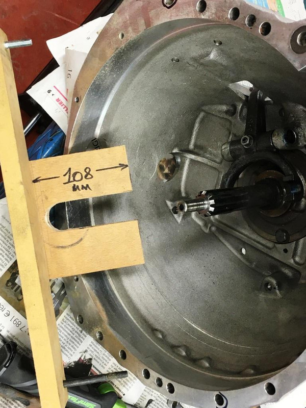

I decided the easiest way to see what was going on was to make a jig, makes a change from a bracket.
The clutch thrust face is 108mm from the block face.
The wooden jig replicates the thrust faces with regard to the release bearing.
Looks like this once fitted.
If I use the new fork (no wear in the claws) with the thickest of my two bearings, it's worn but equates +/- 1mm to your 34mm one, then the operating arm is only 5mm off running out of space and is about to hit the case.
So even if I swap the thin (25mm, probably 10" release) for a new thick (34mm, 9.5" release), I'm still going to have insufficient movement.
I'm beginning to think that my Medatronics 5-speed bell-housing isn't quite like the original, because the worn "thick" release bearing (which should be for a diaphragm spring clutch) had been in use for 5 years paired with my old spring clutch, and worked perfectly ............
Could Steve tell us more about bending the fork ? I had imagined it was made of cast-iron, but if it's indeed forged steel then I'll certainly have a go.

Ok , nipped up the store shed and did some more measurements for you mainly because I am intrigued. The gearbox has a worn release bearing which (without taking it off) was @32 mm from fulcrum centre to carbon facing. I rigged up the same test set up as you at 108mm to simulate your clutch/flywheel . The fork arm has a clearance of about 10mm to the slot in the bellhousing when the release bearing is extended as you require. I also measured from the centre of the fork fulcrum pin to the bellhousing front flange face and this was 152mm , in case you suspected your bellhousing .

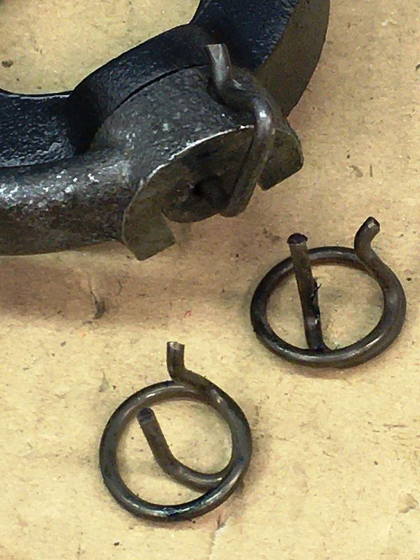

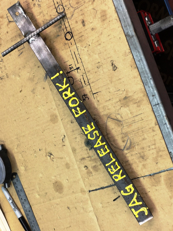

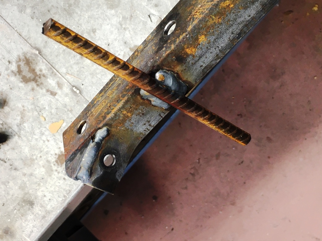

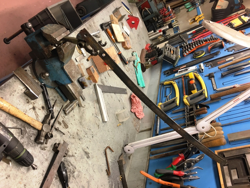

The funny thing is that when I went to 5 speeds, I just flipped the release fork and bearing out of the Moss 'box and fitted them to the Medatronics housing. So I must have had the "thick" carbon bearing in with the 10" spring clutch for 10 years ........... va comprendre.

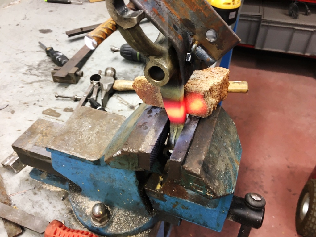

Anyway, emboldened by Steve's glib encouragement, I had a go at sorting out the fork - as I have two, an old and a new, I thought I would do a dummy run with the old one to see where it needed to end up in order to maximise the geometry and get the release bearing where I wanted it.
The precision of the plane of any bend you make is, happily, not particularly critical as there is some leeway and movement at the pushrod end, but making a proper tool to apply the effort seemed important, especially to move quickly and efficiently once the heat had been got into the fork.
The locating pin for the pivot makes a convenient locating place to fasten the lever in place.
The curve of the lever is because it was an offcut from the pergola roof, the weld-marks on it came from it being turned into a chain-whip at one point to grip a bicycle cassette, and the holes in it were from when it was a Renault-5 servo holding prop. A monument to recycling ........
Firebrick offcuts are a good way of getting heat into a part like this.
In the event the bending was pretty uneventful, and after two iterations I had a shape that seemed to produce the desired result.
In the rear, the new, original shaped one ; foreground, the blue-tipped adjusted one.
Seen below, now in position ; this is at the point of contact between the thrust bearing and the clutch pad, and from this point on there is enough movement to give fully 13mm of lift at the clutch before the arm hits the casing.
The kinetics and geometry of the pivots and linkages look perfect.
Seems too good to be true - am I missing something ?
The clips that were supplied with the new thrust bearing are quite different - has anyone used these ? TBH they don't seem to have any "spring" in their steel, and had no pre-load when fitted, and then took a quite easy "set" when I tweaked them, so whilst I like the principle I don't think I'll be fitting them.
Finally, a tool about which I was about to say "don't tell anyone I made this" has worked sufficiently well to merit a spot of wire-brushing, and even get labelled - otherwise I'll look at it in 2 weeks time and have no clue what it's for.

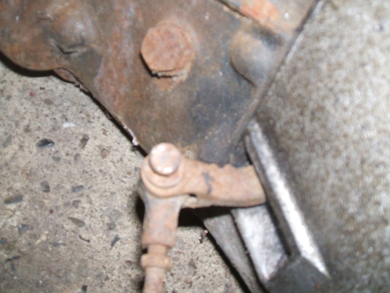

rfs1957 wrote:
Thu Jun 18, 2020 11:07 am
If anyone else can put numbers onto these please pile in, especially if you have some bearings of different heights that may suit the mix-and-match brigade.
Cross reference of vehicles /bearings to add to info if it helps.
Steve3.8
