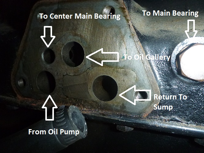

#23 Re: Series 1 3.8 low oil pressure after fresh engine build..Help!
Hi Mike...found this on the US JL forum....may be of intetest. Dont know if its acurate...the post under this photo was posted by one of our experts on XK engins....Steve
NB On later engines the sump return is external (no front hole) the small main feed drilling is plugged (all mains fed from oil gallery).

I managed to get hold of a mechanical gauge over the weekend and screwed it directly into the block to the right of the filter housing which I believe goes to main bearings according to the earlier diagram Steve kindly posted.
So as you will see from the images I will attach I have 60-70 lbs pressure cold on the mechanical gauge which drops to 45-50 when hot having allowed the car to run for 15mins.
