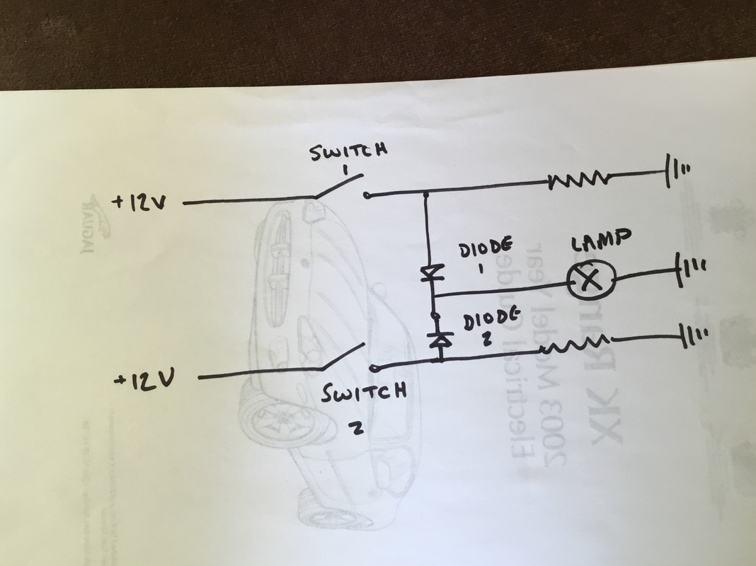

Posts: 9036
#9 Re: Heated front windscreen wiring
Post by mgcjag » Thu Feb 21, 2019 9:38 pm
Hi Paul..something like this should work..however a bit of a rework around the existing heated rear window relay will be needed...the relay is only there to switch in a resistor to dim the warning lamp when the side lights are switched on.......

#10 Re: Heated front windscreen wiring
Post by kingzetts » Fri Feb 22, 2019 10:46 am
Paul,
I’m very far from being an electronics expert either. It was the one science subject I could never get my head around at school. But.....
The circuit below should work, and is a lot simpler than trying to use relays. The diodes allow current to flow to the lamp from either switched circuit but prevent current flowing to one circuit from the other. The diodes will be tiny, about the size of a solid state resistor,and if bound up in the wiring will be invisible.
Semiconductor diodes come in thousands of ratings. You want a basic diode, or a Schottky diode, with a maximum reverse voltage rating of well above 12V and a maximum forward current rating sufficient to carry the current to the warning lamp (I would guess anything above 1amp would be sufficient). They will cost pennies - if you have an electronic store anywhere near, pop in and explain what you want to the spotty youth behind the counter. If not, I’d think a couple of standard 1N4001 rectifying diodes would be fine, such as eBay item number 231206241455.

paulsco
Posts: 825
Location: Oxfordshire
#11 Re: Heated front windscreen wiring
Post by paulsco » Sun Feb 24, 2019 7:57 pm
Thank you Steve and John, I really appreciate your efforts.
