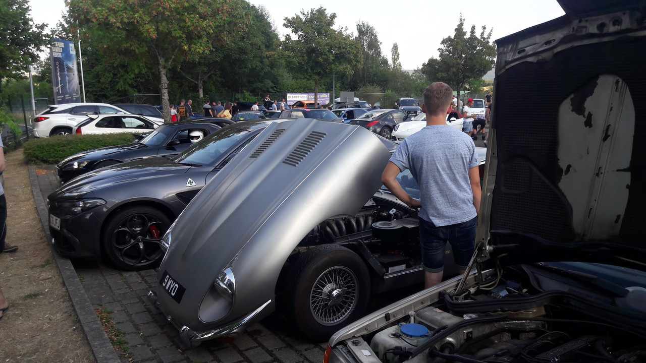

#16 Re: 5 speed options
Yeah!
No problems with my 2.88 and 4 speed Jag box.
Then again, I try to avoid Central London in my E type! (or any other car).
137 mph at the Ring with the speed still climbing when I had to jam the brakes on. No problems.
