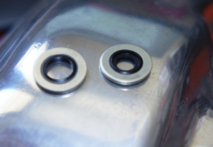

Barnwell have sent me a sample (right) of the self-centreing version of Geoff's 1/4" Dowty-type washers, and they look perfect in that there are two distinct functions addressed, such that their grip around the thread is more snug than the basic version (left), which can't do any harm, see picture.
Reference MBSC45-004 NBR (MILD Steel) - looks like a zinc plated finish.
They're 60p each for orders under 50 pieces, but get a lot cheaper in quantities, so if anyone wants them then I'll happily post 22 of them in exchange for £6, while stocks last.

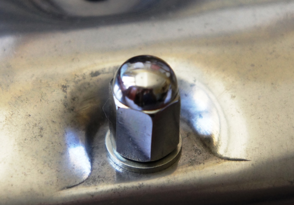

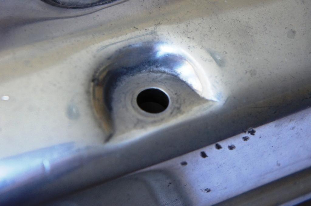

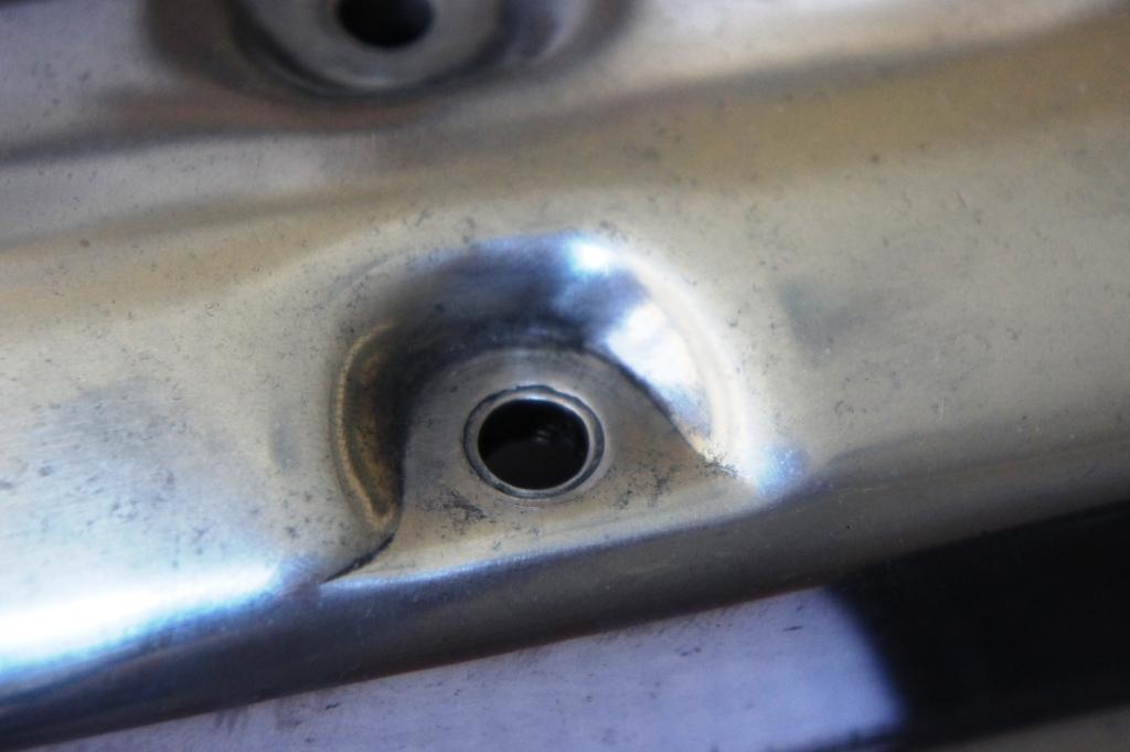

I don't believe they'll solve anything like this
but they feel like they'd probably work with this
and will of course be perfect on good seatings like these

OK, reference is : MBSC45-004 NBR Self Centering Bonded
I ordered 220 and paid £48.22 including VAT and postage within UK.
My contact was doug.bane@barnwell.co.uk
First feedback from a Usual Suspect who has been using the same ones but of a less-appropriate size :
Fitted them today and can see the snugger fit on the threads. Maybe the calibration of my hand needs checking but I felt they needed a slightly greater torque to do up, very much an impression and the torque is still very low, just a light hand-tight tweak with a 1/4 inch ratchet/socket.
Not sure how soon I can get a decent run in to test them but see no reason to think they'll do any worse than mine, which are leak free.
For your information mine have been on for the best part of four years and have been on and off several times. Today two showed signs of delamination which is the first time and they were still lovely and clean on the head so doing the job.
