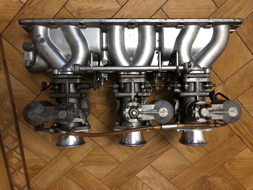

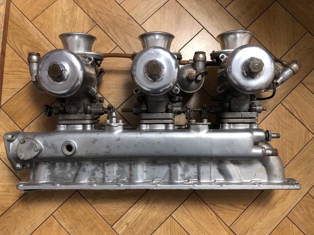

My dad has the below SU Triple Carburettor in his garage. He purchased it for a Jaguar Coupe originally but
would like to know what engine/s it is for exactly? He plans to sell it but wants to get some more information first. Any help would be appreciated. Thanks.

The tag on the float chamber AUD119F according to my SU catalogue is from an S-type HD6.
The carbs you have are HD8's, so I would assume it is not original to them.

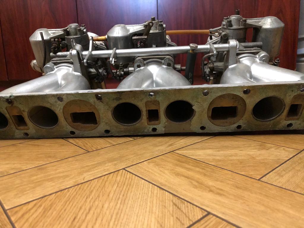

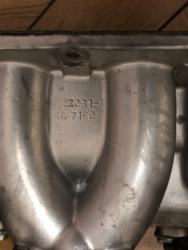

I can't blow up your pictures for some reason, but the picture of the underside of the centre carb appears to have a bolt in the bottom of the float chamber for an AED choke device and the manifold is similar but is not an E-Type manifold. Perhaps it’s from a MK10?

The assembly is basically a MkX 4.2 or 420G manifold unusable on an E-type, with carbs that suit a saloon but are also too tall for an E-type. Not great news value-wise, I'm afraid, but at least you were honest enough to ask rather than put up a misleading eBay ad as some do.

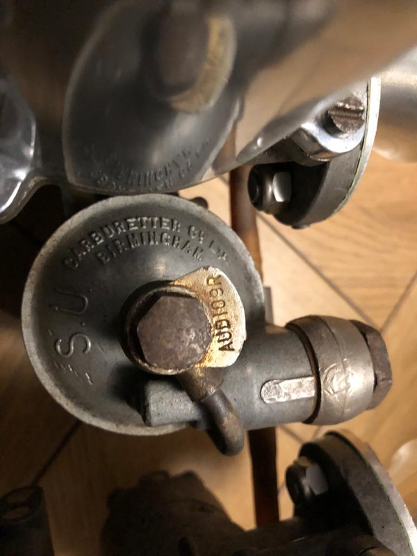

Hello Paul,
Thanks for your reply. The tag you refer to on the float chamber, is it not AUD109R? Or am I looking at something else?

Sadly, the obvious option of converting the carbs to genuine E-type spec with the necessary new parts from Burlen, is probably not viable and you’d still need many hundreds for a correct manifold.
The best user for what you actually have is a MkX or 420G restorer or a saloon upgrader who fancies 3x SUs on ther XJ6. You might get a good price and less risk of come-back there than on an E-type

I can now see that the centre carb has been converted to manual choke as per the E-Type (picture 4).
I assume that was not standard to the MkX etc?
#14 Re: SU Triple Carburettor advice
Post by christopher storey » Sat Feb 08, 2020 11:01 am
It was not. The mark 10 had the famous "hisser" SU starting carburetter which fed a rich mixture to the manifold from the centre carburetter .
