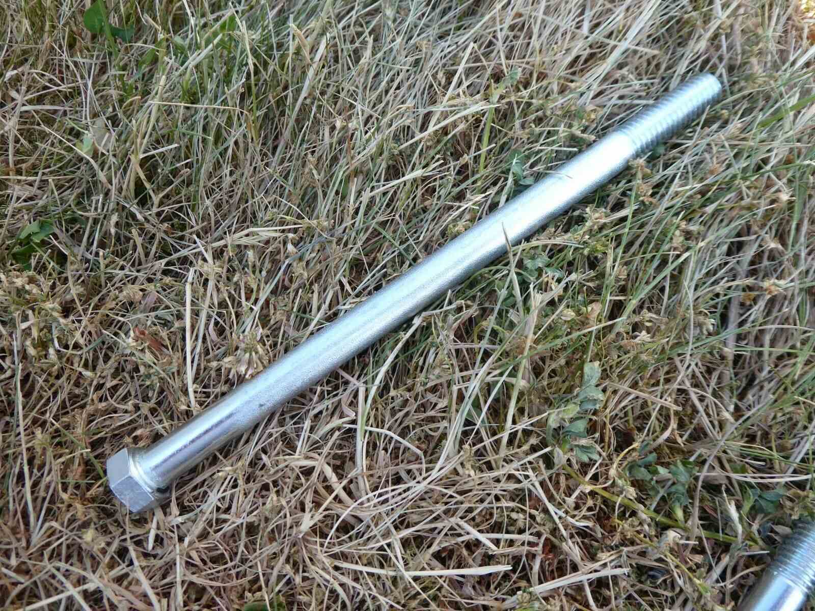

#35 Re: [edited] Spin on oil filter vs retrofitting OEM filter housing on Series 1
Post by paydase » Sun Jun 21, 2020 5:51 pm
Indeed, my bolt does not incorporate a washer:
bolt 3.8.jpg (233.48 KiB) Viewed 9211 times
The bolt for the 4.2 engine does, but was not suited as the seller told me it has a different thread pitch, because of the additional piece to which this bolt is screwed in the 4.2 assembly:
bolt 4.2.jpg (214.82 KiB) Viewed 9211 times
For that issue, it's a simple fix: I will add a washer :wink:

The original bolt has a tapered end to aid location:
paydase
Posts: 695
Location: Belgium
#39 Re: [edited] Spin on oil filter vs retrofitting OEM filter housing on Series 1
Post by paydase » Thu Jun 25, 2020 11:12 am
The bolt I bought, although not having a shim pressed to its hex head, has a tapered end.
I thing the difficulty to ensure a good centering of the bolt is the design of the assembly itself.
The disk (piece nr. 6) that is pressed on the filter by the spring near of the bolt head has a diameter that is a few mm smaller than the inside of the canister.
That leads to the tapered end of the bolt hanging down by a cm or so when approaching laterally the canister assembly from the filter housing.
Also, the design of the body of the filter housing that hosts the threaded part, with multiple ribs and holes around the centre does not help because these holes/ribs can catch the tapered end instead of the centre itself.
Maybe that is the reason why Jaguar modified the design of the assmbly for the 4.2, adding two pieces:
- first a clamping plate (piece nr. 12 here under) to help keeping the rubber seal well centered inside the groove in the filter housing; and
- an anchor insert (piece nr. 11) to press the plate nr. 12 and also maybe for easier catching of the tapered end of the bolt.
factory fit 4.2.jpg (62.03 KiB) Viewed 9118 times
See for refrence that the same pieces 11 and 12 do not exist in the 3.8 assembly:
factory fit 3.8.jpg (57.64 KiB) Viewed 9118 times
