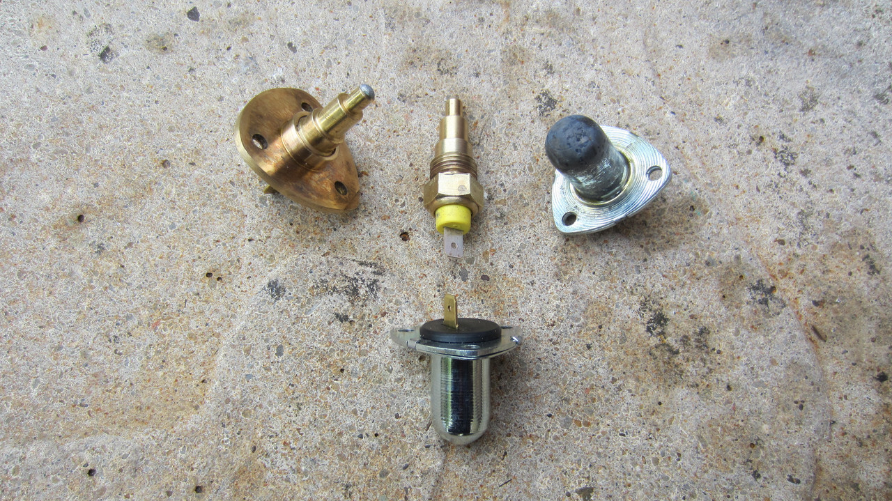

As I have established that my car does not appear to be overheating, but the fan is failing to go off, I thought I would delve more into the otter switches.

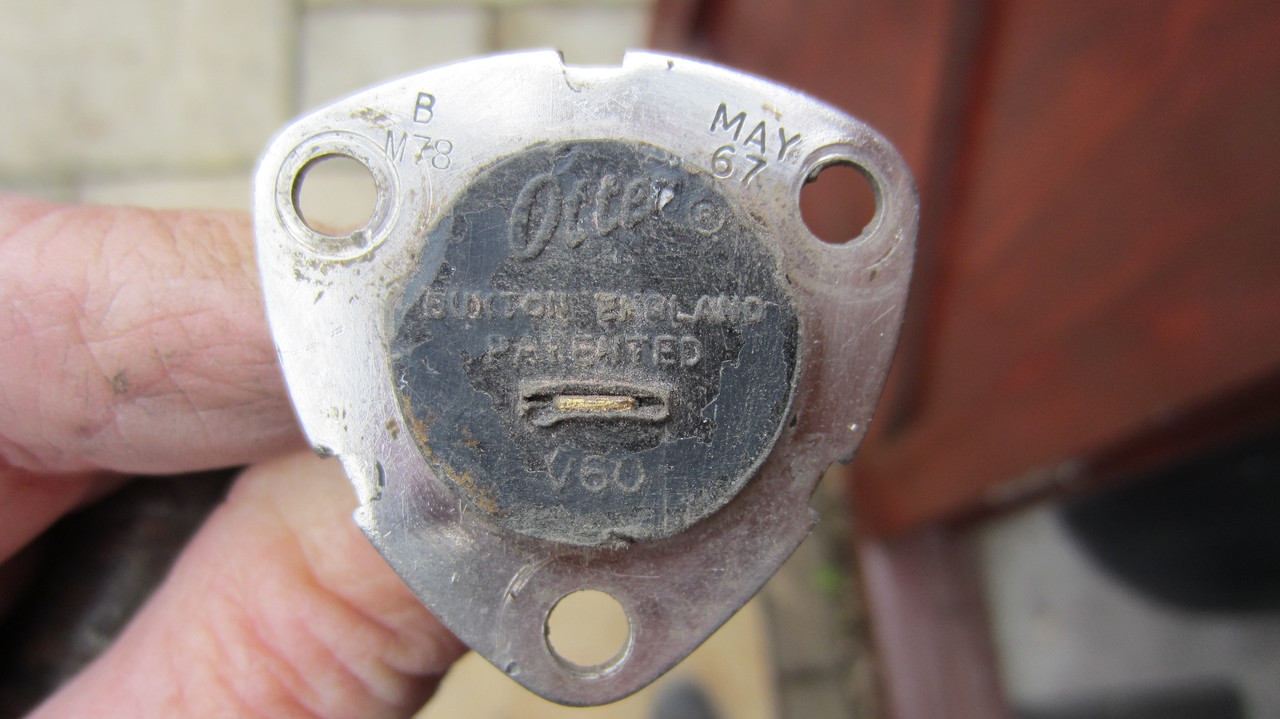

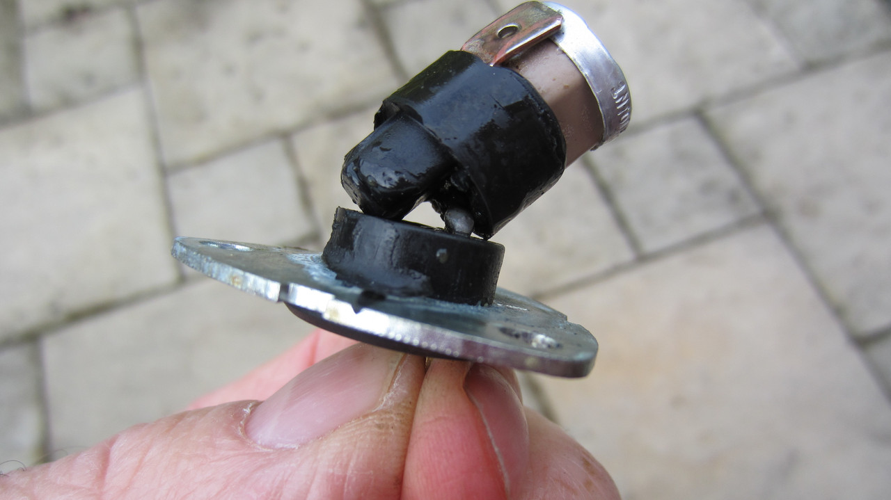

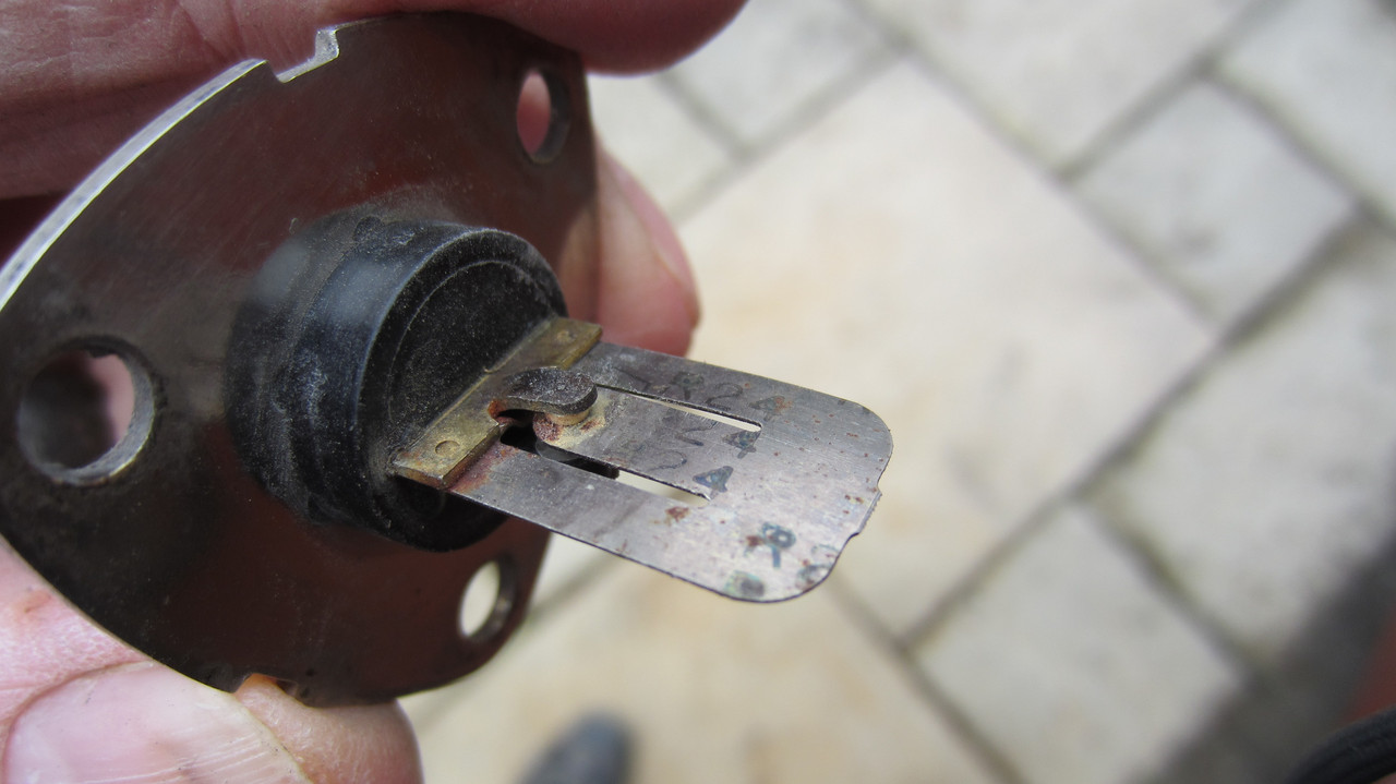

I have an old original otter switch, but the lucar connection has broken off at the base. I had tried to solder on a new connector, but there was not enough of the old one exposed to make a good connection.
I took it apart to see if I could remove the old part of the connector and fit a new one. It is sealed in, so this was not an option. I decided to drill into the face around the connector and expose enough of the old connector to make a reasonable solder joint and soldered on a new lucar connector.
I thought I would test the temperatures of all five otter switches that I now have.
I heated up a pan of water and used my circuit tester and a food probe temperature tester.
The original otter mentioned above went on at 89C and off at 86C. The book says it should be 80/72.
Replacement otter from one of the usuals was on all the time.
The second otter from one of the usuals was 91/80.
First Mitsubishi 91/88.
Second Mitsubishi doesn’t come on, even over 100C.
I fitted the original otter to try it out as it is the only one so far I haven’t installed and from the gauge at 90C the fan came on and went off at about 87C.
The inferred temperatures were all over the place.
The bypass hose remained hot throughout.
I think this will do for now; it is not overheating and the fan is coming on and going off. I will make a further judgement on the road.
