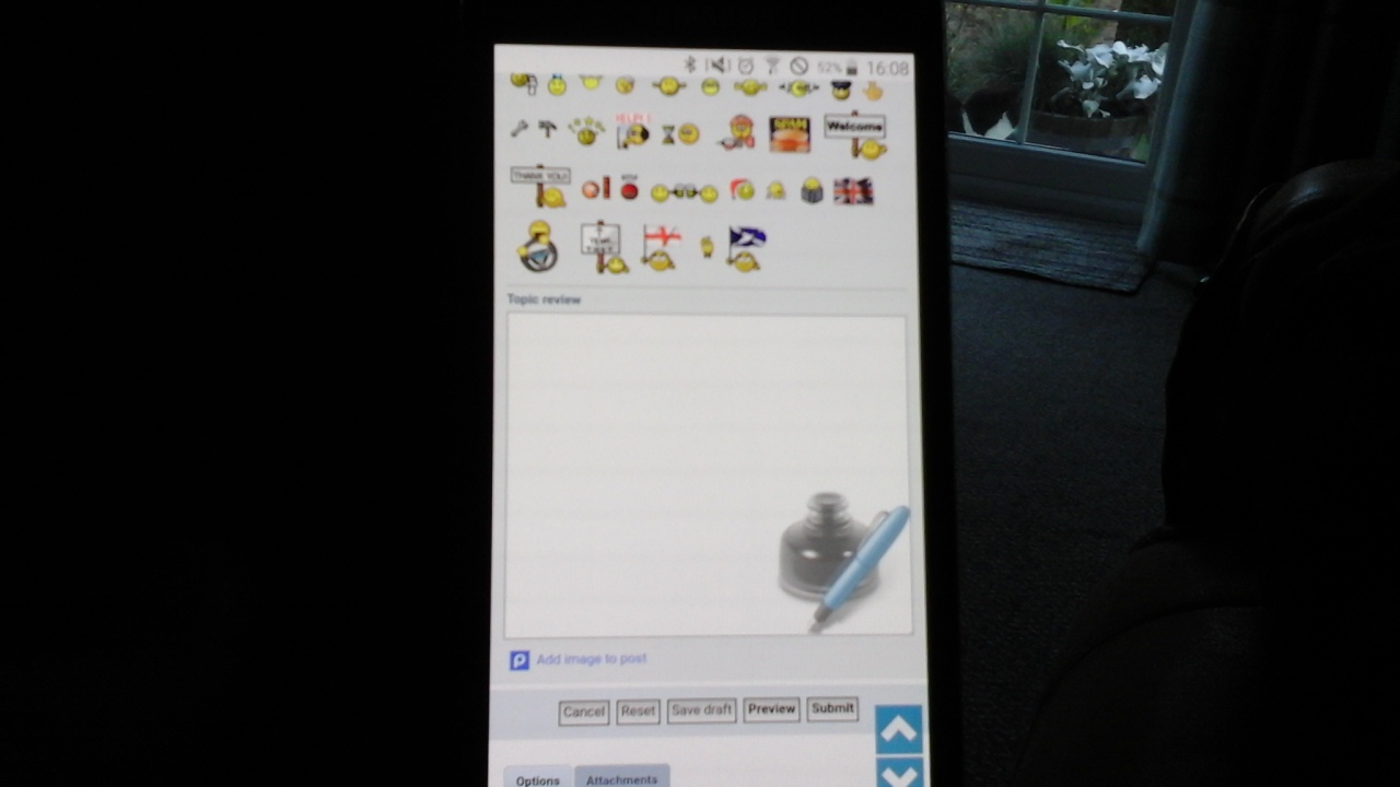

Yup
Thats what i have
But no add image at the bottom left
Joe
Thats what i have
Joe
1969 series 2 2+2
#23 Re: Gaz shockers best or basic setting to start off with
I have options and attachments where you have add image
1969 series 2 2+2
