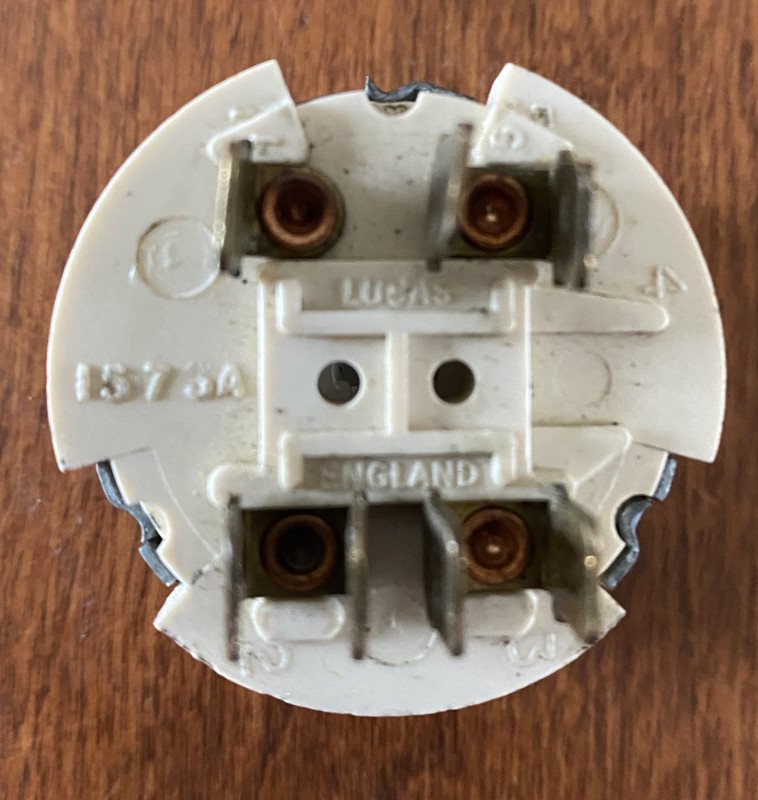

Which switch do you have?
Can you post a pic of the back?

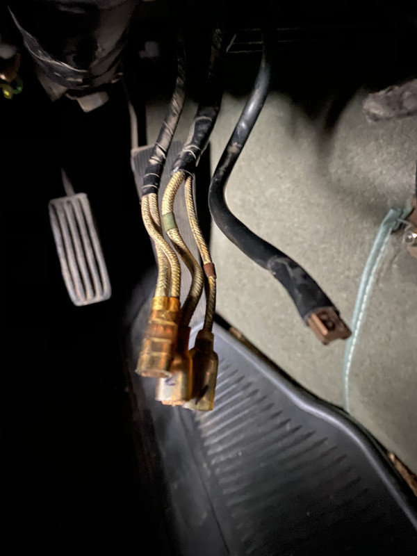

I have 3 single wires and 1 doubled wire that connected to the rear of my britax ignition lock. The switch portion, is a lucas 39449 with 1 single terminal and 3 double terminals.
There is yellow wire with a brown band that connects to terminal 1 and appears to connect to ballast relay on frame by the radiator.
There is a thick brown wire, mostly wrapped with electrical tape, that connects to terminal 2.
A doubled yellow wire connects to terminal 3
Finally a yellow wire with a green band connects to terminal 4 and appears to connect at the other end to fuse number 6
Hope this helps. See pics for wires and back of 39449 switch.
My switch has failed and I have a lucas 39415 to replace it. Anyone know the connections for this switch?

I like how these diagrams are available for some switches. I have not been able to find one for the 39449 or 39415 switches yet.
Does anyone have access to those?

Hi Roy.....your switch has....157SA on it...?....quite a few diagrams if you google search 157SA...Steve

Are all 157 sa variants the same then? The 39415 is also stamped 157 sa with completely different arrangement of connections.

As the only way I could take a good look at what was going on with the wiring it helps that the drivers seat comes out in a few minutes to allow me to crawl into the footwell and look at the harness.
My understanding according to the wiring schematic is that the white wires present are either plain white or white and blue and white and red.
However..... all the dye on mine has faded and they now look all white and yellow!
However there is an easy way to identify where they go.
Two white/red wires? that share the same spade connector serve the coil and the fuel pump.
There are two single white wires, however one is of a noticeably larger core than the other.
The larger core wire serves the ignition and the smaller core serves the starter solenoid relay.
Two further brown wires one of which is a larger core serves the battery whilst the smaller serves the starter solenoid. The larger of the two has a piggy back spade connector to attach both wires together.
Looking at the rear of the ignition barrel there are four connectors with identifying marks.
Sorry all my attempts to provide a photo have failed so I will try and explain where they go.
In a clockwise direction:
2 o'clock double connector 'R' twin white / red wires? (fuel pump and coil)
4 o'clock double connector '15/54' larger core single white wire (ignition)
7 o'clock double connector '30' both brown wires (battery and starter solenoid)
11 o'clock single connector '50' smaller core white/blue? wire (starter solenoid relay)
That's it.
Hope it may be of some help.

WIRING INSTRUCTIONS ARE AS FOLLOWS
         "30"  -     BATTERY SUPPLY (BROWN WIRE)
       "15/54"    IGNITION SUPPLY (WHITE WIRE)
          "R"        VEHICLE ACCESSORIES (WHITE/PINK WIRE)
          "50"       STARTER RELAY  (WHITE/YELLOW WIRE)
           The "R" terminal briefly disconnects when the starter is operated.
