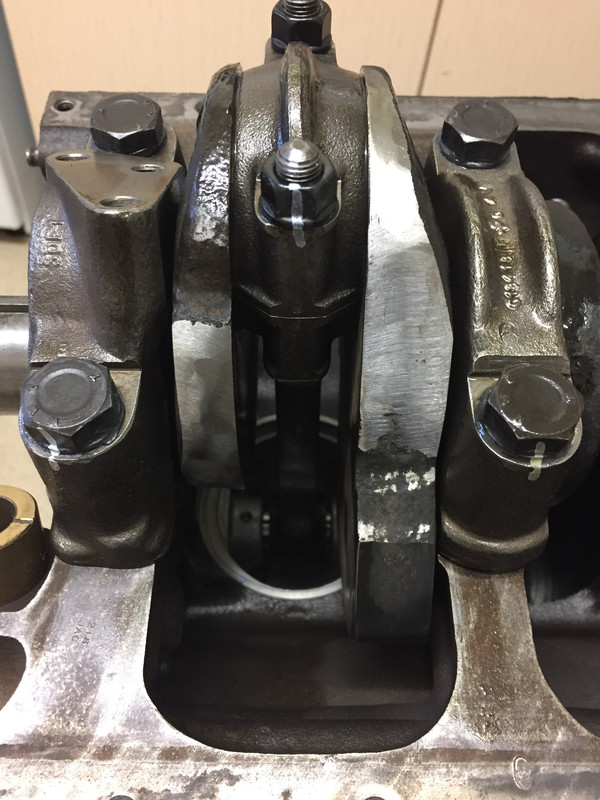

I’m not a engine builder by trade but a helicopter engineer. With all the engines I have rebuilt, from car and bike engines to racing outboards. I always get the machining work done for me at a local shop and then methodically rebuild the engine myself. It’s quite a simple process but cleanliness and patience is key! I always balance the engines both in static and dynamic, my 4.2 crank required a lot of grinding to get it in balance!
Rebuilding an engine yourself is very rewarding but ensure you get it balanced.
