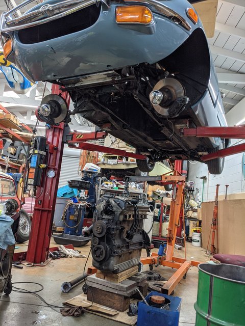

#20 Re: Problematic shift into first gear when stopped
Replaced the master and slave cylinder, plus the flexible coupling of the clutch line. Not much better, so...
Removed the engine.. Splined shaft bone dry. Release bearing completely worn out (previously observed).
To his credit, a Jag mechanic I contacted suggested grabbing a can of spray lubricant and lubricate the splined shaft via the release fork opening and inspection hole (series 2 have an inspection hole?).
My machinic didn't wish to pursue this because the release bearing had to be replaced in any case.
$$$ repair for $50 part. He going through the transmission as well, replacing bearings, synchros, etc. plus motor mounts, u-joint bearings, water pump, etc.. Considered a 5 speed but, a) difficult to source, and b) many said stock transmission is awesome, keep it!
That's it!
